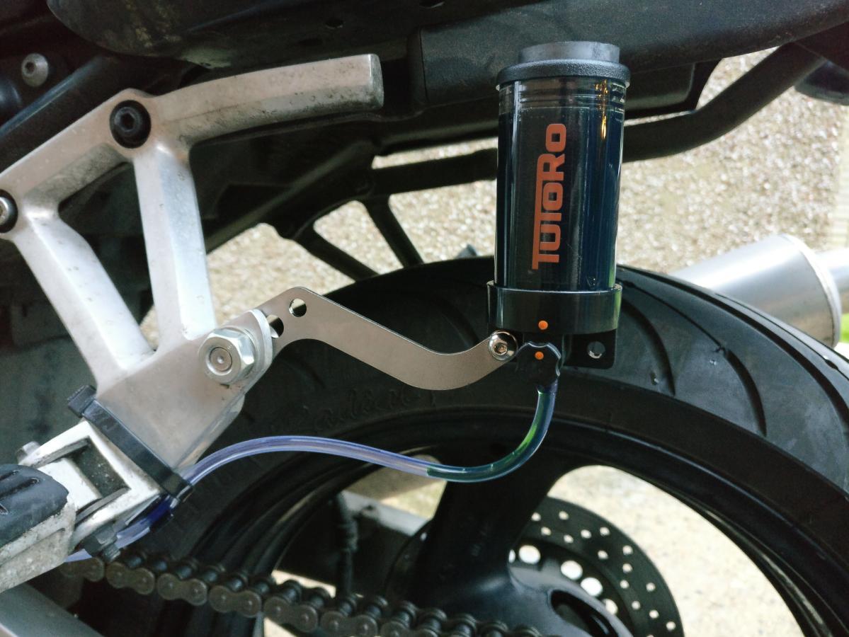

I fitted a Tutoro chain oiler on the 'winter' 600 this morning. At dinnertime I went for a 20 mile spin to check the flow rate. I had to decrease it a bit. Started raining half an hour after I got back. I shall tidy the zip ties up in the morning and, weather permitting, go for a longer ride to fine tune it..

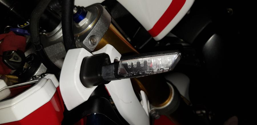

Fitted my some Oxford L.E.D turn signals today. After much pissing about with resistors and stupid Yamaha connections I finally got them working but then to my dismay realised they don't fit without some kind of spacer/blanking plate?
I've used the stock bases for now but looks awful. The back will need something similar too,
Does anyone know what I'm looking for?

I have a Tutoro fitted to my MT09 great bit of kit, I think you could remove about a metre of the plastic piping there though. I have my feed screw set at about 1/3rd of a turn open get about 700/750 miles before needing to top up again current chain and sprockets 15,000 miles, front sprocket showing a bit of wear, but I do have a tight spot on the chain, no noticeable wear on the rear. I even have the feed set up as you have.

Yep. You need these. I bought these for my 2008 Gen 2 a couple of years ago. Got mine from M&P's though, not this American site and they were cheaper. Maybe contact Oxford direct and find out where your local dealer is.  https://www.motosport.com/oxford-indicat...source=pdp

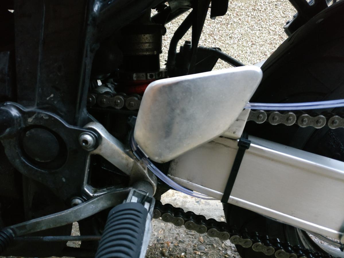

I fitted a Tutoro today too as it happens. I didn't check on here to see how anybody else had done it before so my route is a bit tighter than Anquetil's one.
Seems to flow just fine though, I'm working all weekend so will see how it holds up on the commute!
Hi Lew. I have done a few hundred miles since fitting it and I am delighted with the results. Yesterday, I was out in the rain and mud covered roads for 90 miles and the chain was lubricated and clean when I got home. I bought an oiler as I was getting through a chain and sprockets in about 12000 miles, probably not helped by riding every winter in all the salt and crap. My mate has an oiler fitted and he is on 38000 miles, and his transmission is still in good order. This prompted me to fit one. I take your point about the excess plastic piping. First one I have ever fitted. I wasn't sure where to route it. I used to lubricate my chains in the tin of heated grease many years ago !

Spot on, thanks Grayo.
I knew there must be some kind of nicer looking solution to it haha I was ready to use washers is nothing else bit these are perfect ?
That is much neater than my routing effort, mountaingoat. I shall have to have a rethink.
