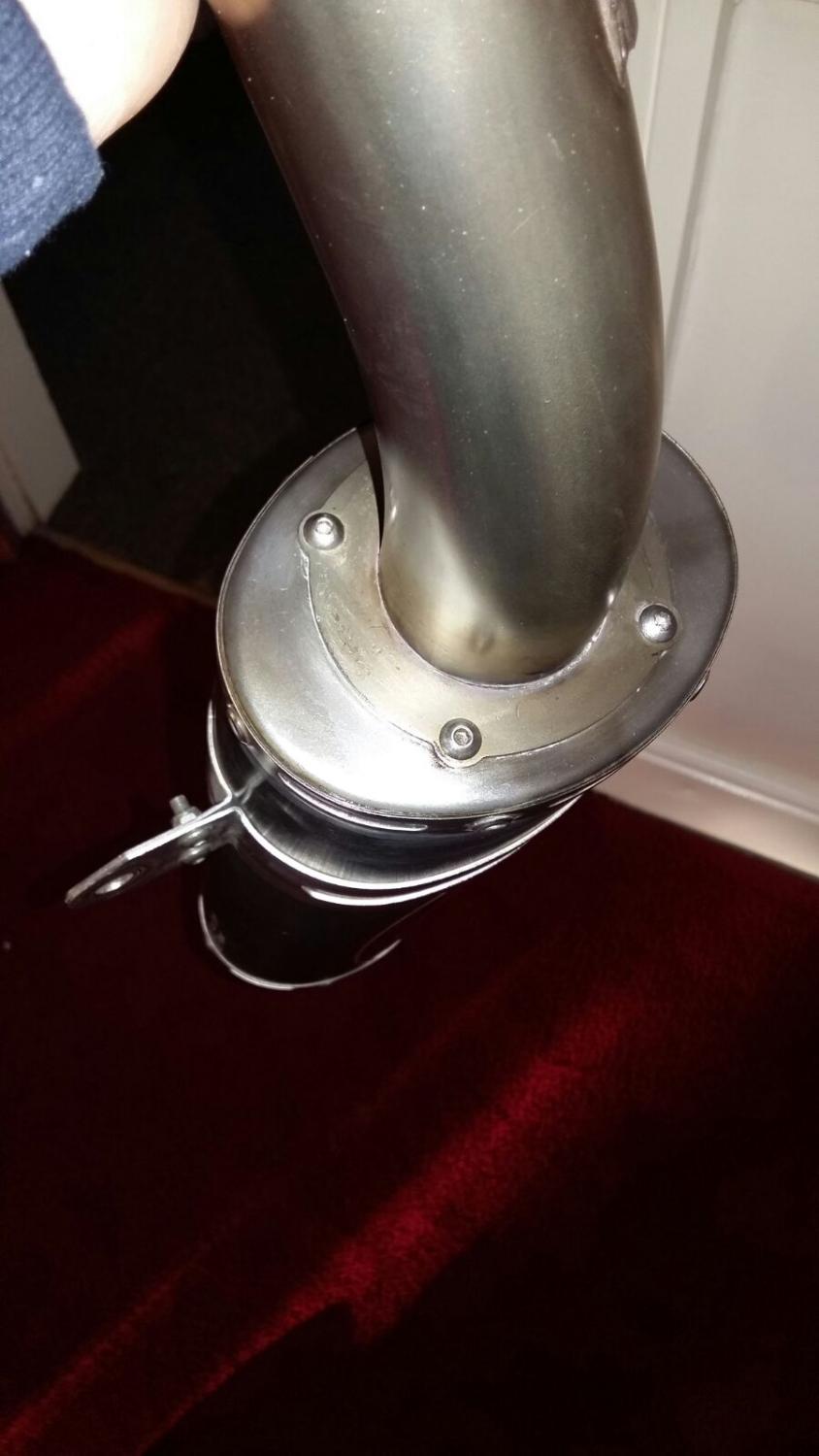

Ever since fitting the Pc3 and mapping my bike I developed a major exhaust leak at the join between link pipe and end can so took that apart today and used some liquid gasket to seal it. Figured I'd give it a clean and polish while I was there and replace the bolts with nice new stainless ones. All in all quite productive ?

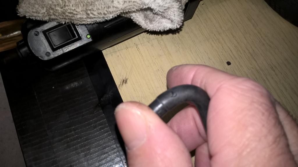

Replaced the weeping Carburetor Coolant Hose on the replacement carbs must have been pinched in the packaging as it is behind another which is undamaged  Smile

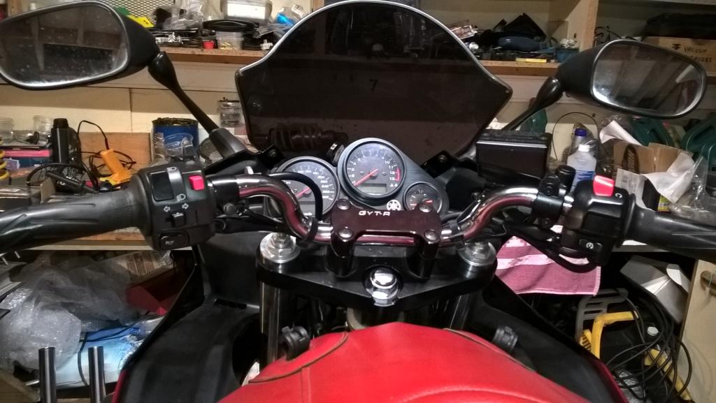

Fitted Fzs600 bars and GYTR riser to the Fzs1000, bars slightly further forward, 25mm narrower and lower than the OEM and feels better sitting on it Smile
Raining now so cannot take it for a run to see how they feel :'( roll on tomorrow

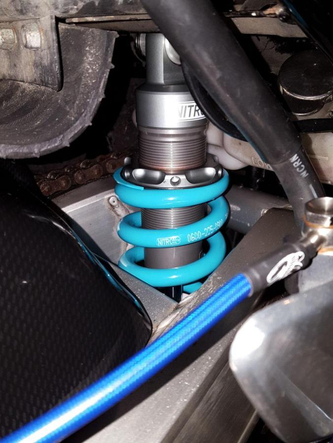

Well busy afternoon for me, removed the mono-shock/pogo stick from the back of the 600, removed the dog bones and the shock linkage, good clean up of all the parts, washed all the needle/roller bearings out with W/D40 and gave then a really good clean and dry, repacked them with red grease (more resistant to water than regular grease) and fitted the new Nitron shock.
I did the work with the bike on the centre stand but slipped some thin planks of wood under the back wheel so it did not drop when removing the bolts, new shock and all the bits just slipped into place no lifting pushing or pulling involved.
Jobs a goodun.
Before I started working on the old girl I put a sticky label on the seat fairing vertically above the centre of the rear wheel and measured up from the centre of the rear wheel spindle 400mm and put a line on the label, with the Nitron fitted it now measure 403mm.
The unladen (Just weight of bike) sag is only about 15mm so I will set that to about 30mm in the morning it might just drop the measurement back to 400mm as well.

I fitted the Nitron shock yesterday after stripping out the dog-bones and linkage, I was informed that the Mono shock can be fitted with all this stuff in place.
Not sure why anyone would want to do that as it is an opportunity to have a good clean up, and check, clean and lubricate the needle bearings on the link and swinging arm to dog-bone connection (6 of them in all).
Everything is in very good condition all the needle bearings still had some grease in them and none of the pins that pass through the bearings has any sign of wear, so all is good.
The Nitron is a magnificent piece of kit, beautifully made and looks the bogs dollocks on the bike.
