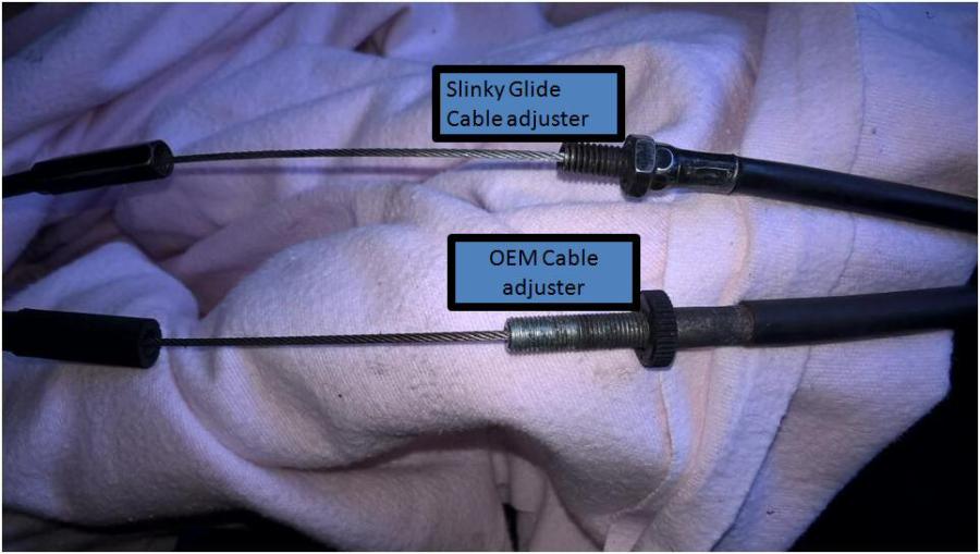

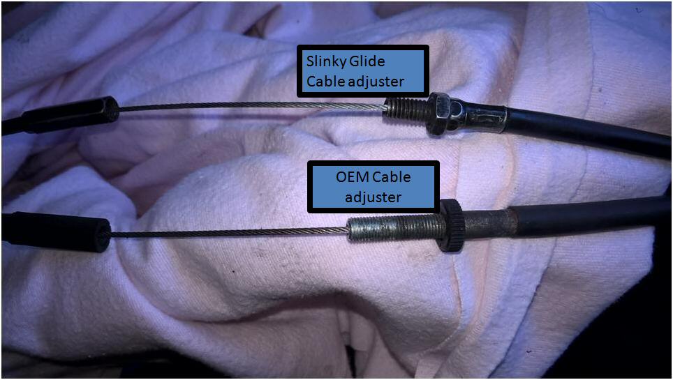

		Fazer 1000 was feeling a bit dead and EXUP was Rattling. Had a set of Slinky Glide cables in with about 20,000 km.  they must have stretched a bit or settled as the EXUP was so far out it was hitting the exhaust at rest. Up with the tank to adjust it and ran out of adjustment before it was set up correctly, Foc :'( . Had a good old OEM set that came with a servo I bought over a year ago. Swapped them out and was able to set it up correctly. Way more adjustment available with the OEM ones. See pic. cables are exactly the same except for the adjusters. Then checked the TPS as the tank was up and that was way off also :rolleyes . Went for a short spin to fill the tank and check it out, what a difference, back to nearly pulling the arms off in 2nd and 3rd again :woot Just need a new back tyre and will be sorted for the UGP :thumbup Sportec M7 RR lasted 7000 Km, front is still good for another few 1000Km.
