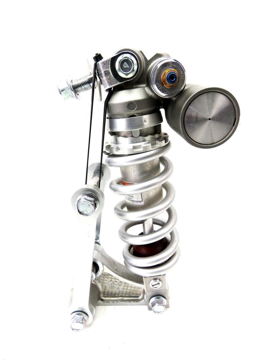

Ordered an R6 2015 shock for diy fit.
I'm going to use a top hat reducing spacer for top mount.
Does anyone know the sizes I will need so I can get them made before strip down
From what I have read Dia are 12mm into casting on frame and 10mm bolt hole for new shock
I need to know how wide frame casting is and the gap size created by new shock.
.jpg   $T2eC16dHJGYFFk3-7TReBS!1U7lB!Q~~60_57.jpg (Size: 135.69 KB / Downloads: 269)
We're is the rubber mount that will be solid 2015 need the earlier bush pressing in and you will need to make a tool also it's a kayaba unit and not as good as the early ones
But fair play for having a go
How can you tell the difference between the two?
Looks the same

This is same as one my mate has for sale off early 2015 R6 1500 miles on it.
That is not the 201 unit but it is the one you need

I will wait until I receive the shock, its on its way from USA, just to make sure
Its supposed to look the same as the one in pic but want to make sure.
