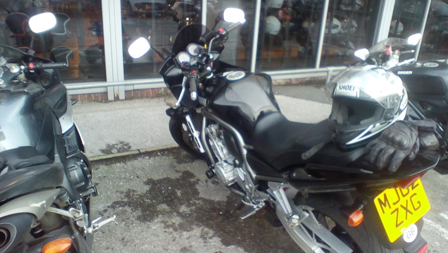

As the sun was shining and the roads were mainly dry , took the bike for a spin around Bristol , stopping in Fowlers on the way back .
