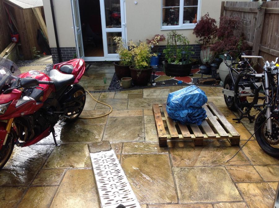

Dry washed it.......

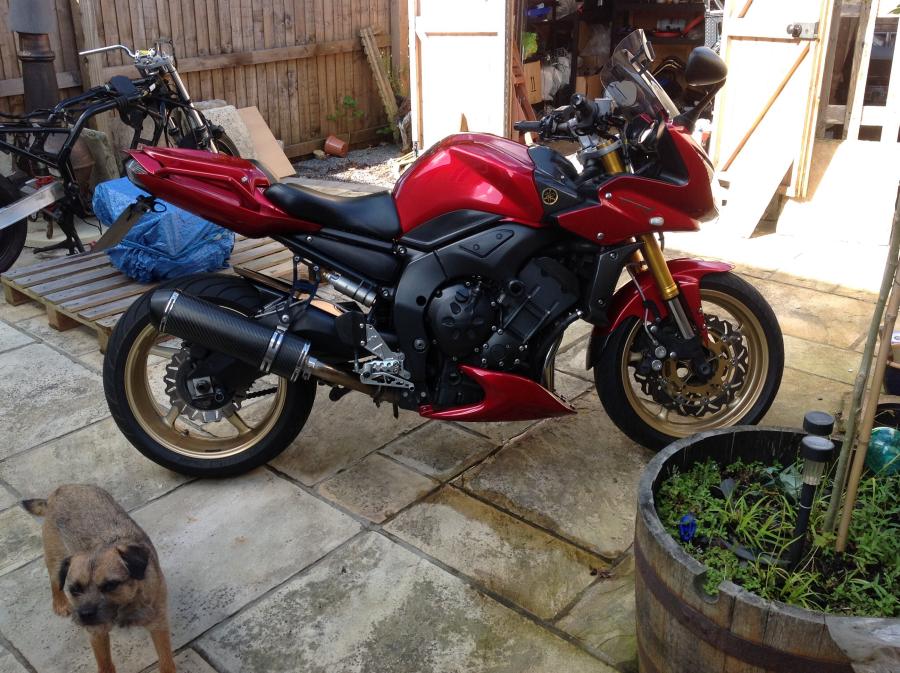

Managed to find the code on my nitron shock....on the spring......at the front out of sight and barely readable/slightly worn off......got the head torch through a tiny gap in the frame and got the code and good old Nitron were able to advise that it is indeed the correct spring for a man of my calibre Wink .
Got some penetrating fluid on the rebound adjustor......tomorrow ill take the right hand foot peg assembly off so i can get a proper grip on the dial.

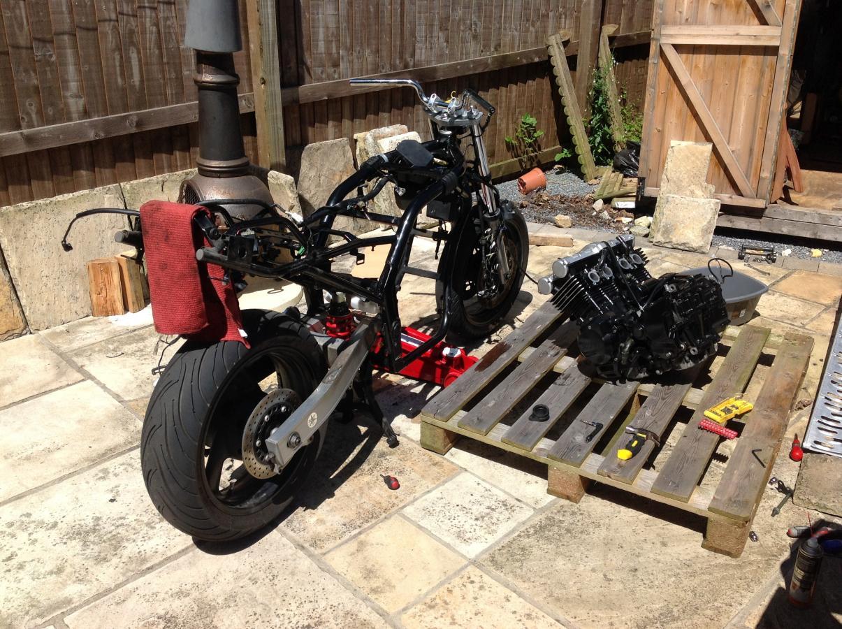

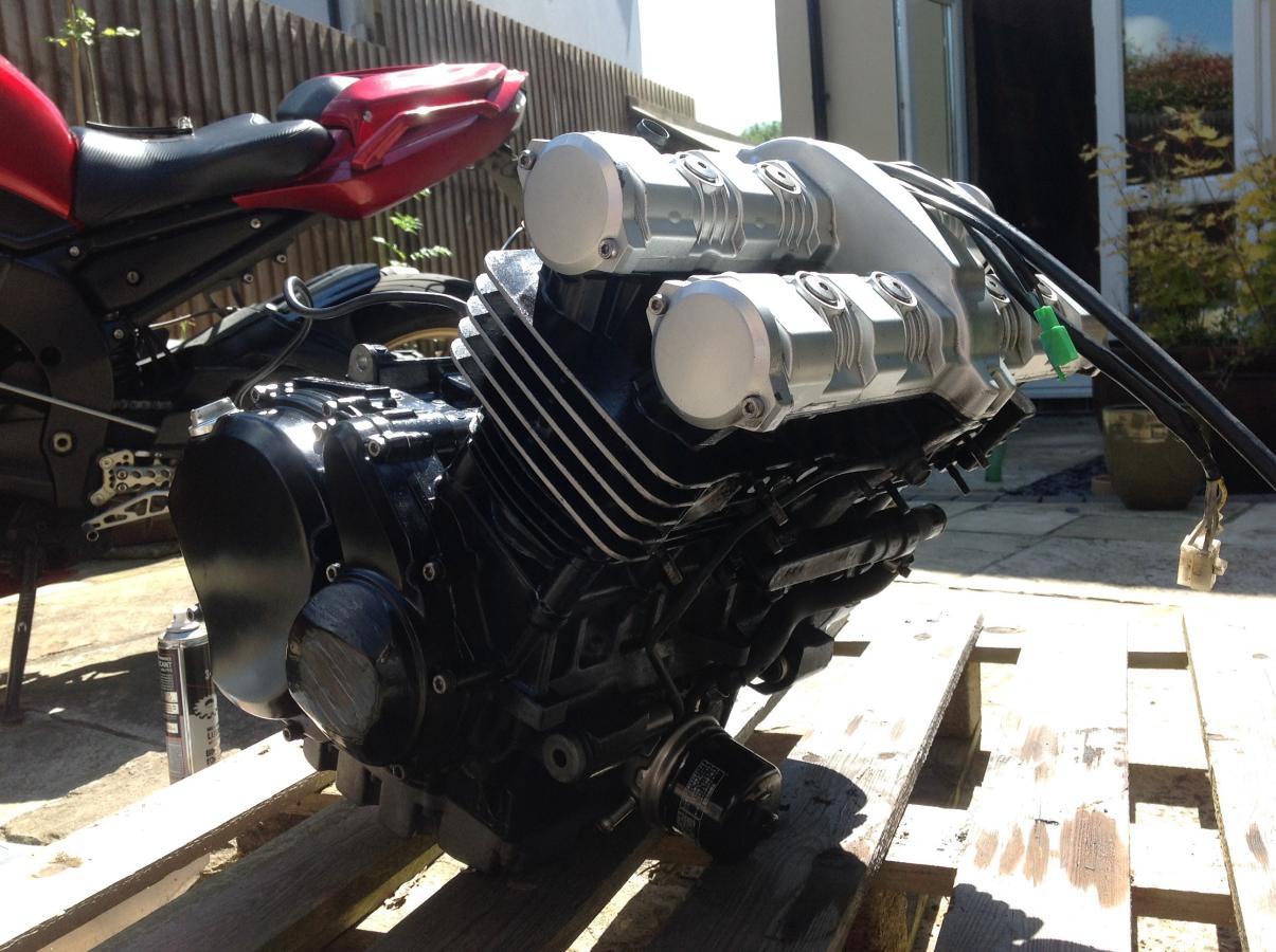

Stripped more of the 600 down....getting as much as i can outta the way before i attempt getting the engine out.
Looks like im the only one doing stuff to fazers.......except riding them :rolleyes

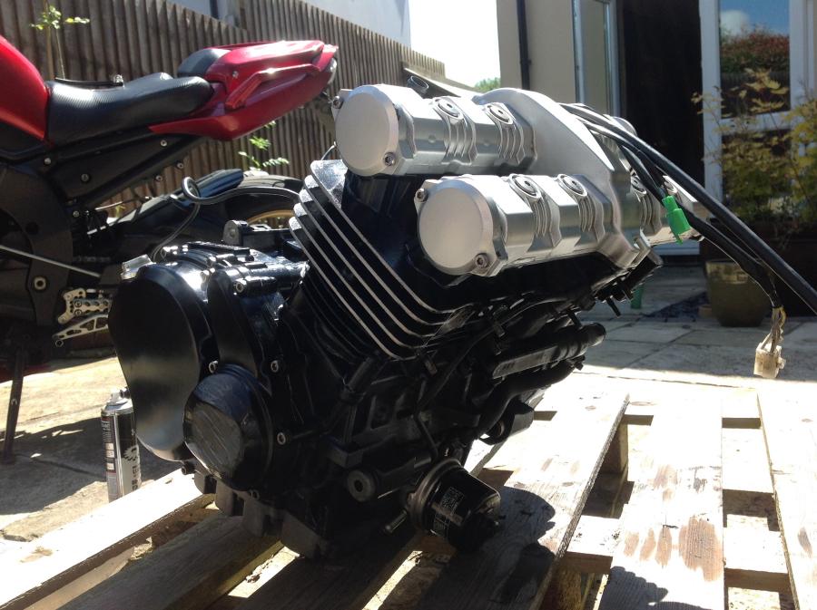

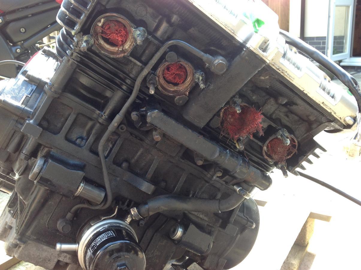

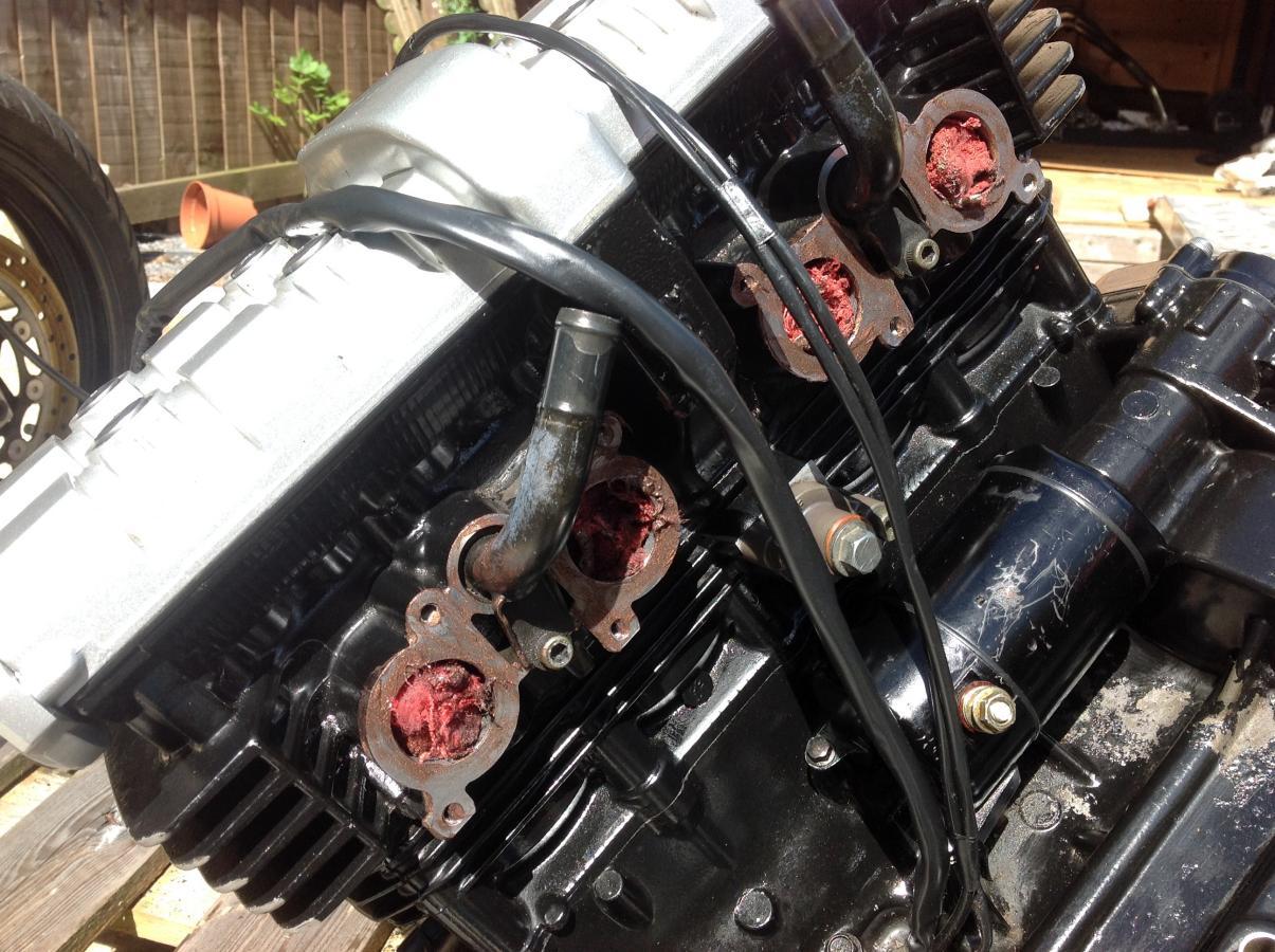

Well...i got the engine out......gave it a wipe over with some oil........blocked all the holes........greased over the exhaust studs to stop any rust......copper greased the exposed metal.
Then i wrapped it up.......cleaned up the garden.
Washed the thou......a productive fazer day really. 8)

Phoned Nitron to ask why over a week later i dont have my c spanner.....they are a good bunch and didnt have my phone number......they are just introducing a new tool which is a needle tool rather than a c spanner so at least ill get one of the latest tools which should hopefully be better.
I also managed to free off the rebound adjustor.....with the help of some more penetrating fluid (best aldi buy ever) annnnnnnndddddd......Mole grips :eek .........it worked though.
So i got hold of the Nitron baseline settings...the settings that they think suit the weight of rider and spring etc.....so maybe not perfect but ive read allot about folk never needing to sway from Nitron baseline......i already know I've got the correct weight spring.....there baseline is 8 clicks compression and 12 clicks rebound.
Ok so lets compare that to the apparently "set up" settings it has been on when i got it.........0 clicks compression......& what now after freeing up transpires to be 0 clicks rebound :rolleyes
I've now set them both to the Nitron baseline settings and maybe in another week i can set the preload properly.

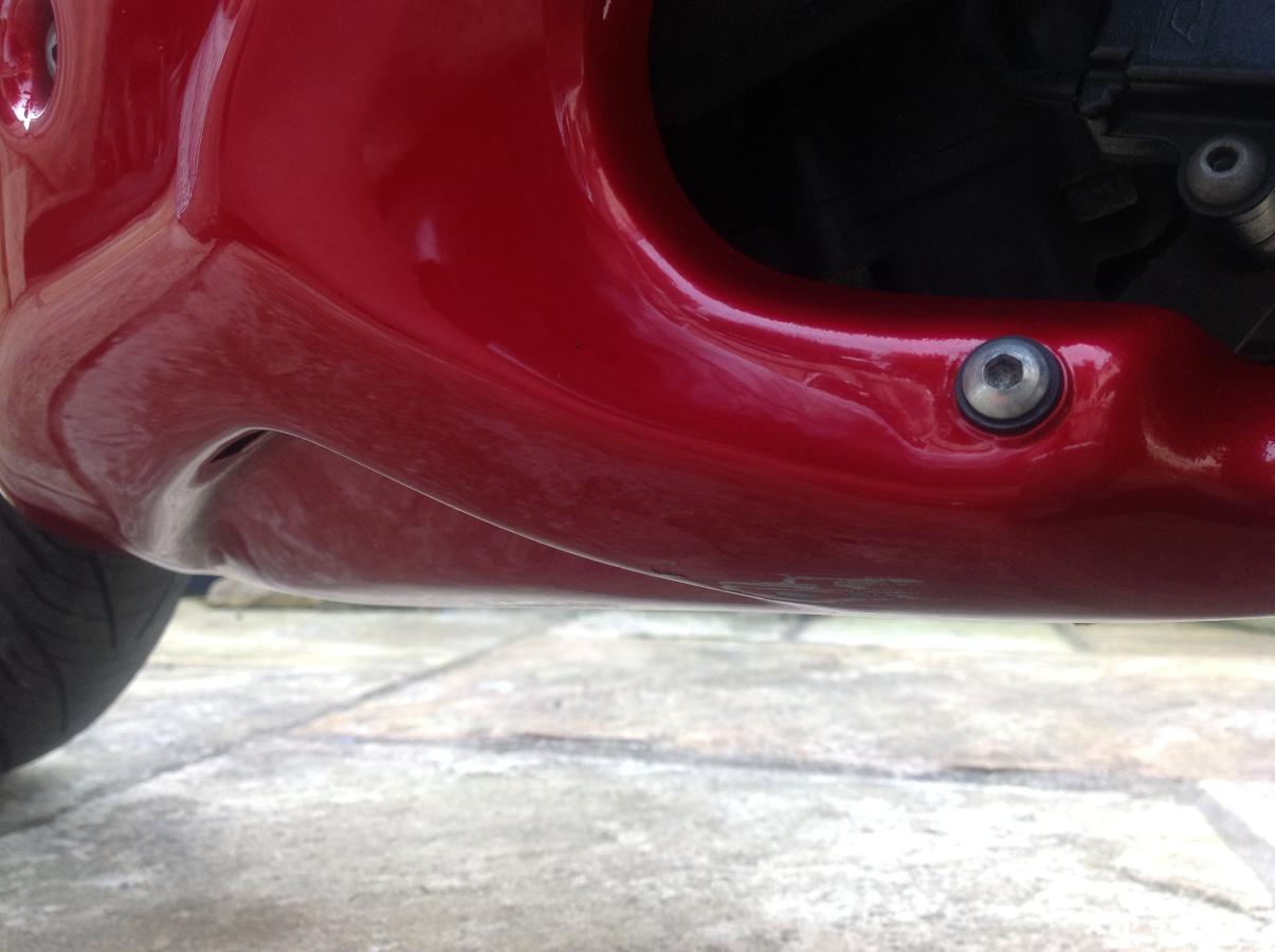

Next on the agenda is raising my yokes back up as i clearly need more clearance......i just noticed i've slightly scuffed the left side of my belly pan like the right and i don't even like left handers......& before you start slimwilly no I'm not bullshitting and i aint no Rossi :b [size=78%] but it is what it is.....most likely less clearance....heavy lump rider and incorrect suspension set up.[/size]
Yeah, a really bad shaped wide belly pan,,one for grandad i rekon :lol

Thats the yokes back up to standard....with the added benefit of not so much slanting downwards then maybe it will help me stay on the seat more instead of sliding forward.
Anyway im looking forward to actually doing some welsh roads on it soon.

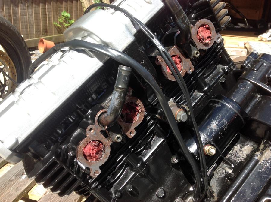

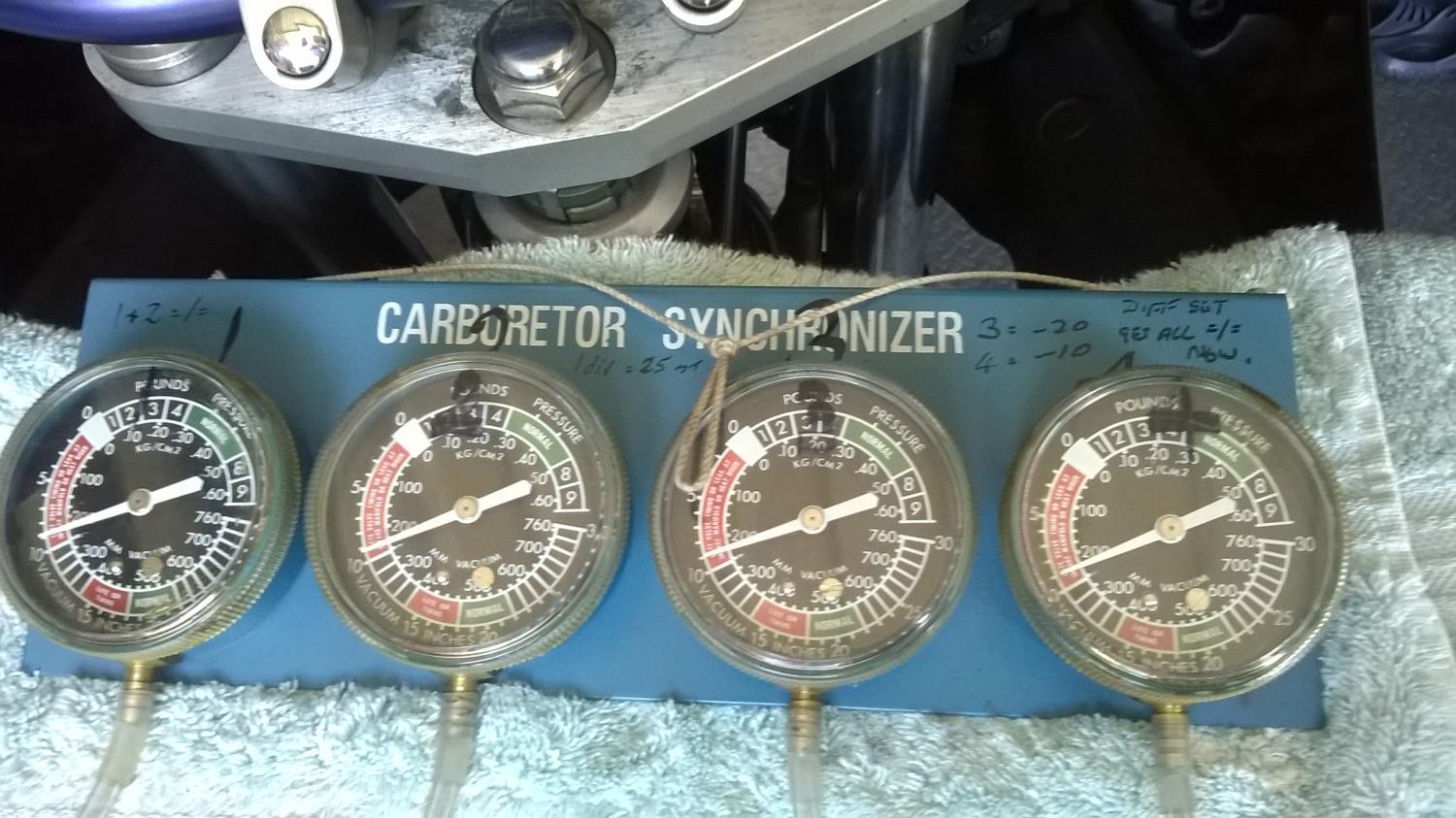

Balanced carb's, fiddly but good now, about an hour total.

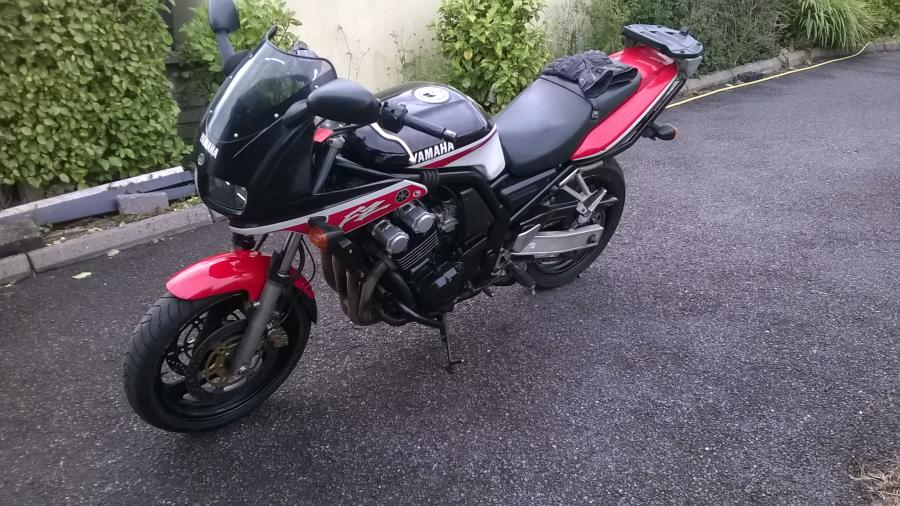

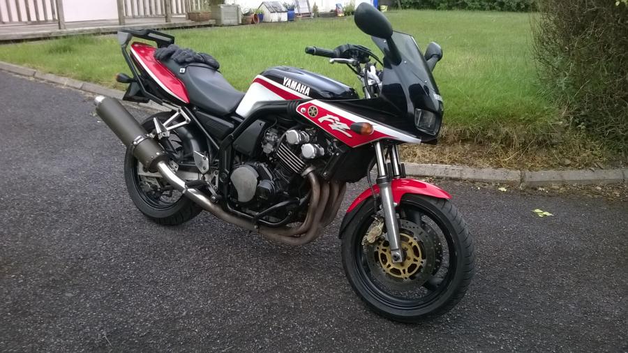

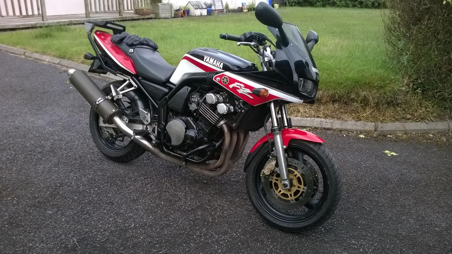

Forgot to attach these last night of how the baby Fazer looked in the last pictures taken before it left my ownership. Smile
