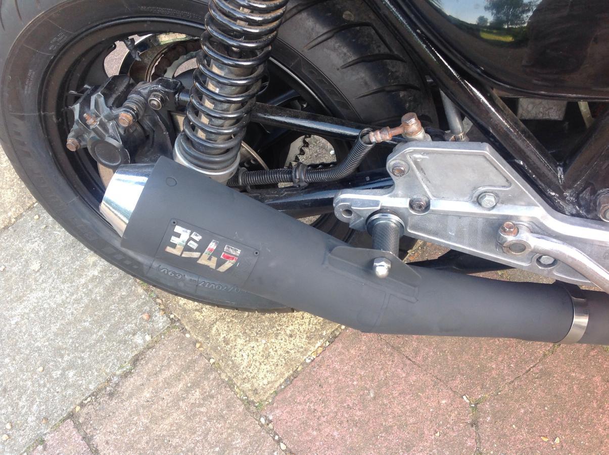

Sorted the exhaust today. It's pays to never throw owt away lol, I still had some exhaust gasket rings from that 1170 elr I did up years back..welded up the holes in the bottom( how the fuck did that pass an mot the day before I looked at it!), cut two inches of the link pipe to shorten the whole thing and inch and a half of the back to expose the alu cone. Polished that up, riveted an old yoshi plate onnit, and prepped and painted. Much prefer the shape of it now, that old kerker megaphone look doesn't do it for me, looks a bit more Harris like now,and replaced all his dodgy fittings, and made a nice carbon tubed sleeved bolt for the rear.repacked it, it's a little quiet now, but still sounds lovely when it comes on cam. Unbelievably only one thread to sort out on this job( put a timesert in the cone) all the studs were good. Makes a nice effing change...strange thing is as much as I moan about working on this bike, I'm loving it. And I'm loving the bike, it's actually a lovely old ride on a summers evening.

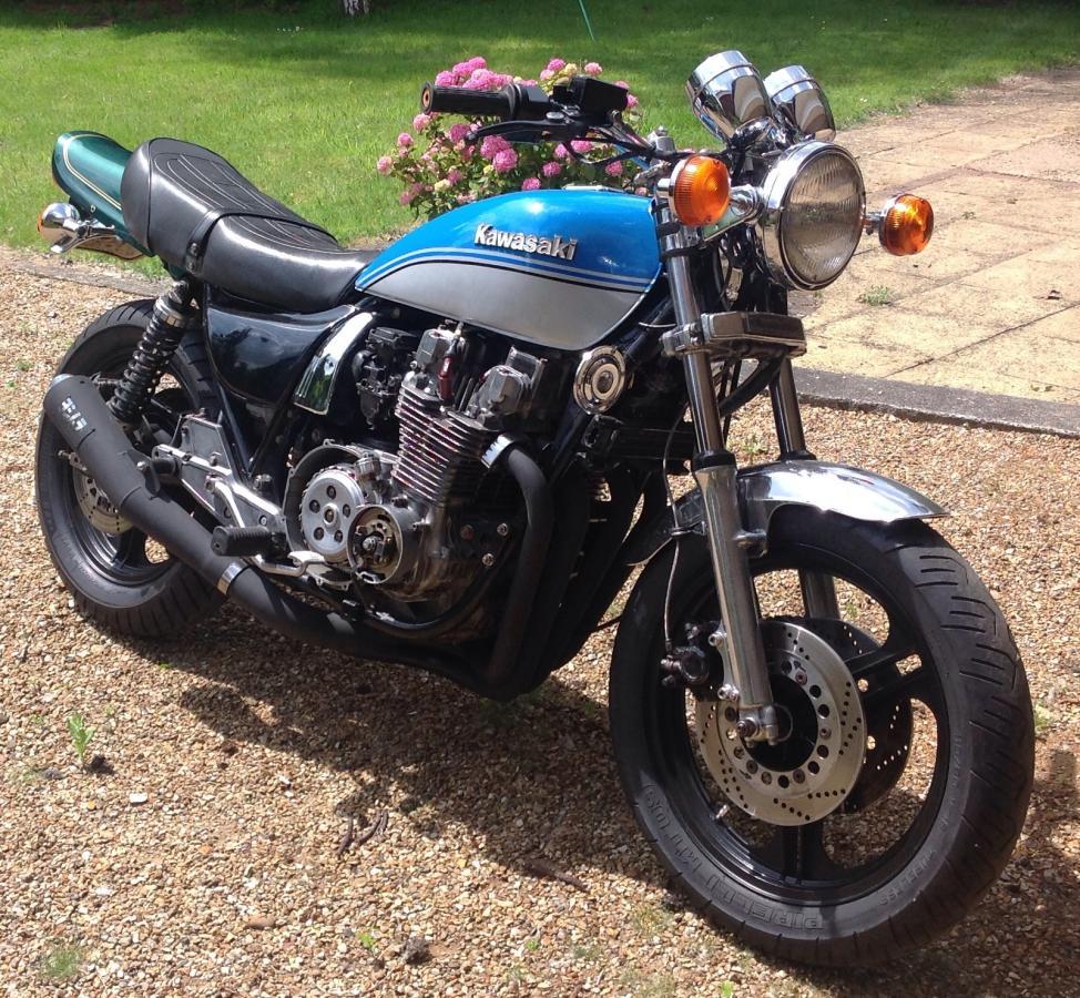

Z1 tail on, along with a kh250 rear light and z650 bracket. Much better overall shape...
#33
Tailpiece was a bit duffed up with holes in it but it's getting filled and painted so not a prob. Made a start on cleaning the motah up..Genny cover had a small crack in it so a mates getting that welded, I've started with the wet and dries and polishing linishes on the other engine side covers..that 32 year old. Alu comes up a lovely colour....still enjoying it, but got a feeling the carbs will have some unpleasant surprises..them cvh diaphragms are fifty quid apiece and there's bound to be at least one out of the four that's been bodged judging by the other stuff I've found on the bike. New gaskets all round and fresh oil and filter, and numerous other small but time consuming jobs..
#34
This bike will only ever be one thing..a very poor mans z1b rep. But that floats my boat...I was hoping to get it done including buying the bike for under two grand all in but it's gonna be closer to £2200-£2500 now I've decided to go the whole hog with paint..For that money I can justify keeping it.
Got a bit done over the weekend..stripped the tank back and only five small dents that have been filled over its 32 years..not too bad I guess.
Fitted a z1 grab rail..involved hours of fannying around getting it to sit just right including welding new brackets in exactly the right place, but well worth it. Anything that gives it a z1 look at a passing glance helps it's case. And it fits in with keeping the chrome muddie at the back. More hours spent polishing engine cases and side plates. And a few with a dremel and countless brass cup brushes polishing the engine..I want it to look clean but I don't want it to lose it's authentic patina...and I deffo don't want it to end up looking like a tarts hand bag... Just want it to look used but loved. As it will be.
Some small touches that lose it's last tenuous links with its previous life as a lardarse cruiser...got shot of the chrome trims on the airbox, chrome horns, and painted the emissions boxes on the rocker cover black...their obviously still there but nowhere near as noticeable. It's getting there blokes..been vying between the kh indicators in the rear and the bulbous Zthou ones on the front, but dumping them for the smaller kh items front and back. Need to make some alu plates to replace the to tomasselli headlamp ears, sort the Rear footrests etc etc but it's not far of ready for paint..just gotta fill the holes in the tail and prep it. Centre stand will be one of the last things to go, it's been damn handy....
