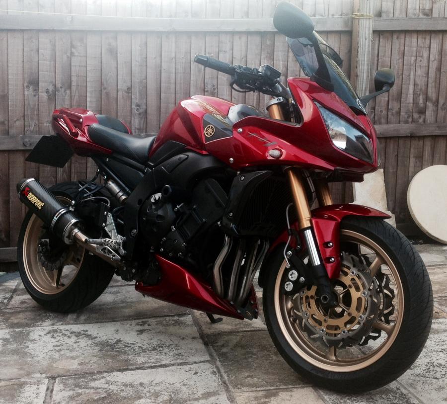

Just cleaned the bike, and scrubbed the chain and sprockets before 're-oiling as well:
[Image: y4egezut.jpg]
