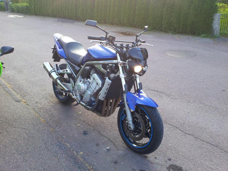

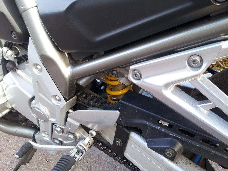

Mounted the shock yesterday without any problems. Looks really good with the polished dog bones and the yellow spring against the blue paintwork. Haven't had time to ride it tough, waiting for the rain to stop...
But just getting on the bike and bounce around on my fat ass, I can already tell the difference in how well the stronger spring and comp-dampening works.
Aiming for a test drive this weekend. Will post my opinion and some pics after that.
cheers!
/Adam

Went for a test ride yesterday and I'm really impressed by the behaviour of the bike. Much more controlled over bumps and steering is also faster. But best of all is the fact that it does power wheelies in 1st and 2nd without nothing more then just a twist on the throttle. Big Grin
This was a great upgrade for this bike!
