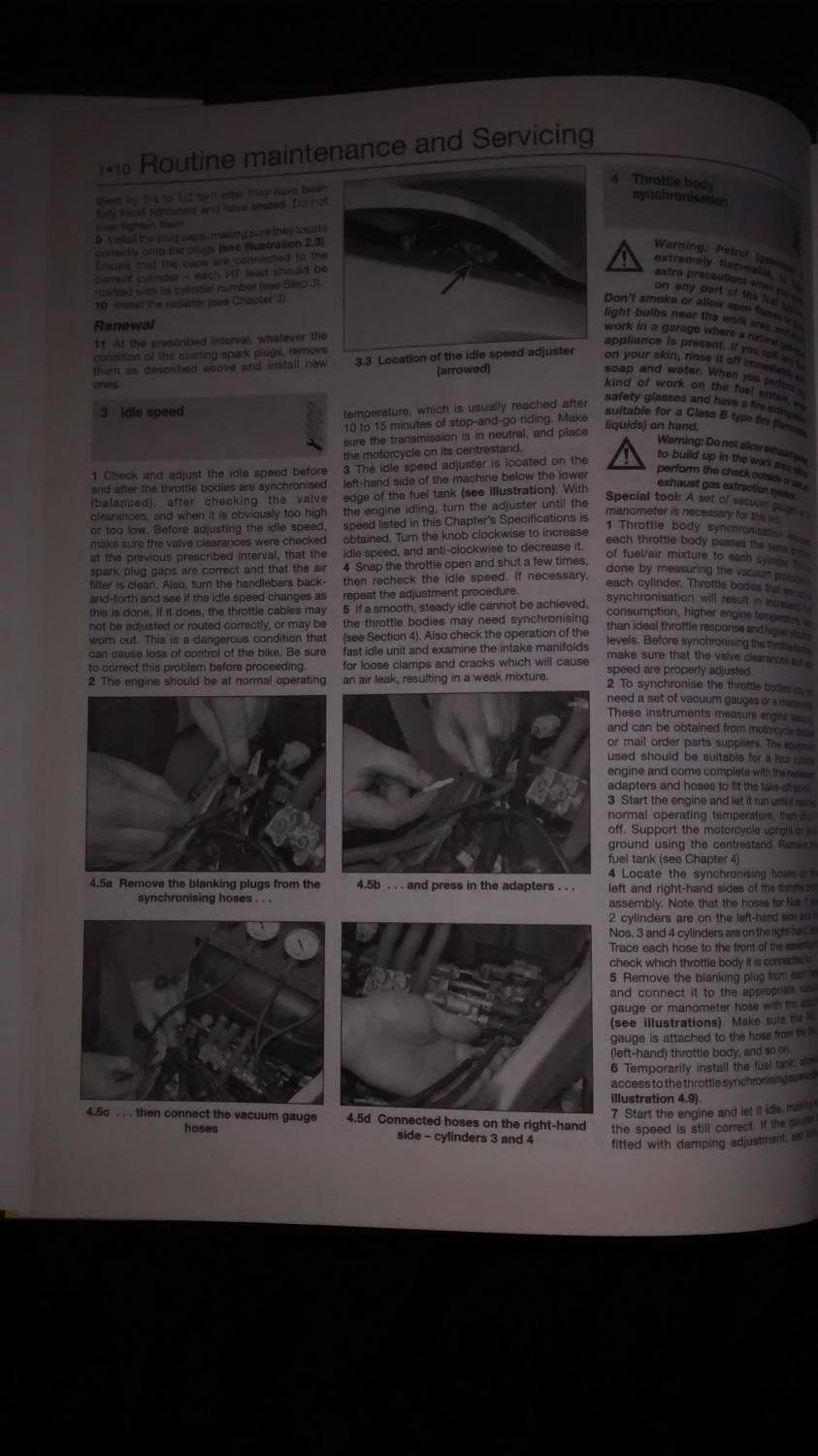

Re: Fz6 fazer idle - Grahamm - 28-12-15
(28-12-15, 09:50 AM)Dimitar link Wrote: hi, haynes manual is for the old model, i have FI system
This is the Haynes Manual for the FZ6.
Here's a photo of the page detailing how to adjust the idle speed:
Re: Fz6 fazer idle - Dimitar - 28-12-15
thanks, will try, i have somekind of vacummeter, today was 16 sunny, drive, already keeping 2000-2200, is needed valve clearance checking? the manual yamaha Fz6 400 pgs, the idle procedure start with valves
