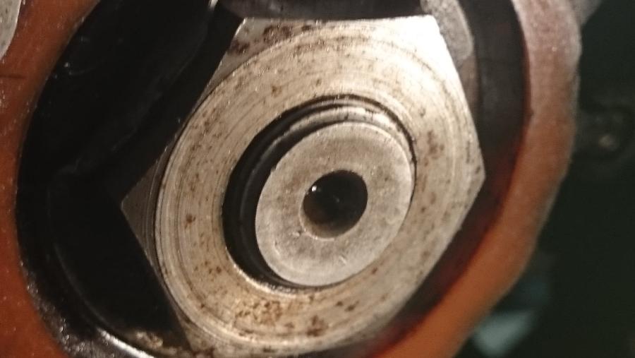

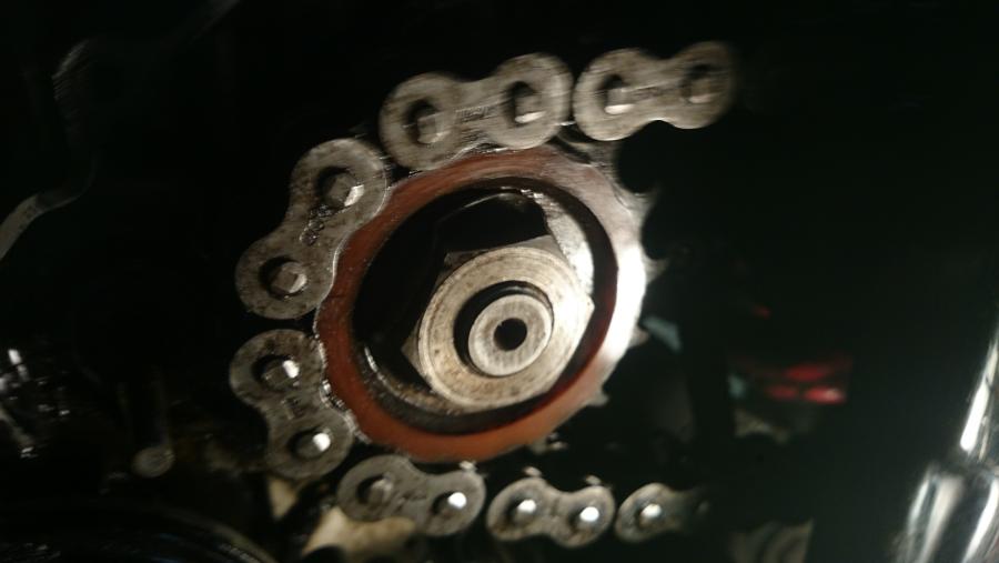

Here's a couple of recent pics of my nut, ooh err missuss, but it's been on my '98 27500 miles bike I guess from new, but I'm really not in any rush to change it although I've got the new nut and washer to do it, as I think if it was going to come off, it would of by now surely?
I'm waiting till I get a new chain and sprocket set, then I'll do the lot together.
Just thought I'd show it for comparison.

Yeah that is what mine looks like, i can see the thread like that on mine when i shine a torch down on it, i will get it done sooner rather than later just for peace of mind, if it came off and wrecked anything i'd kick myself and my missus would rip my other nuts off over the hefty repair bill haha
