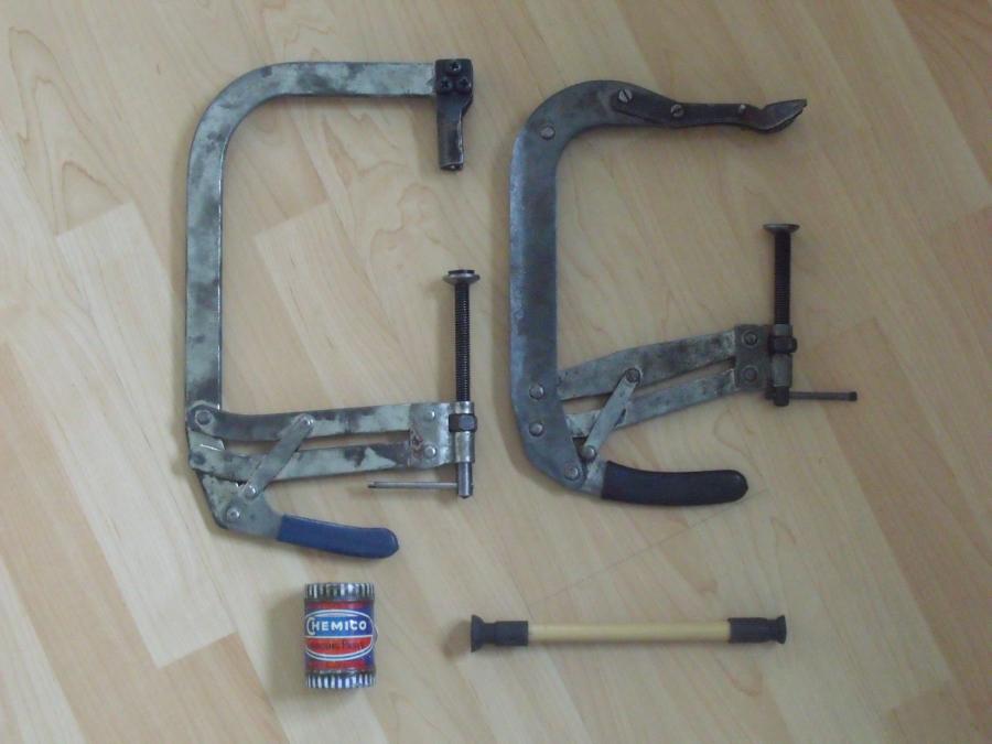

Re: Engine Rebuild - Dead Eye - 01-04-13 Ah, that makes a bit more sense ![]() I have just bought one of those cheaper kits as the valves really do need a clean... lots of crap has fallen in to the intake especially What exactly is required for grinding the valves? I was potentially just going to remove them, tidy them up, then replace Re: Engine Rebuild - limax2 - 01-04-13 Grinding the valves in is really just a case of cleaning up the seating faces to get a perfect seal. All you need is a small tin of grinding paste, sometimes comes with both fine and course paste, and a valve grinding tool which is a piece of round wood with a rubber sucker on the end. You will probably only need to use the fine paste. Make sure you clean it all off after and don't get it anywhere else. You should end up with a nice smooth matt finish all round the valve and seating faces. Re: Engine Rebuild - red98 - 01-04-13 well worded LIMAX2.......i`ll post some pictures as soon as i prise the laptop from my sons hands :rolleyes Re: Engine Rebuild - limax2 - 01-04-13 Further thoughts on the valves. The exhaust valves on the 600 are only 21mm dia so the sucker on the stick needs to be no bigger than about 19mm dia. Plenty on e-bay but any half decent car accessary shop will have the tool and paste for less than the postage cost on e-bay. Also only use the fine paste and don't over do it, just enough to see a smooth even surface. Maybe 10-30 seconds rather than minutes of lapping. In theory it can close up the valve clearance, but you shouldn't be removing a measurable amount of metal anyway. There is an opinion that it's best to leave them alone if they seal and look o.k., but I faviour a quick fine lapping if the heads off. Re: Engine Rebuild - red98 - 01-04-13 two pictures to show the tooling and the grinding paste Re: Engine Rebuild - red98 - 01-04-13 whoops.......that was meant to be two different pictures :o second one a close up of the grinding paste but i think you can make out the wording on it.......two grades in one tin,course one end fine the other,i used the compressor on the left which is for ohc engines,i ground down the top clamp to fit inside the head.it worked well.the sucker stick has two sizes of sucker and you can just about get away with the smaller one. LIMAX2, sounds like you`ve done this job a few times before looking through my "stuttering" thread i came across some before and after pictures of my head....page 4,reply 418 + 490..
Re: Engine Rebuild - Dead Eye - 01-04-13 Thanks limax2 and red ![]() I actually bought some of the Chemito stuff and the sucker from eBay earlier today as it wasn't overly expensive. Some of the valves look a little stuck at the moment and I wouldn't be surprised if they need a little bit of grinding. Through experience I know to take things easy instead of using brute force all the time ![]() I'll keep you informed with some photos as well ^^ Need to sand back and re-spray the external of the head as well as the the rest of the block ![]() I reckon the hardest part will be dealing with the timings when re-assembling and I'm leaning towards replacing the cam chain since I have the engine in so many pieces already, but they aren't cheap! Re: Engine Rebuild - limax2 - 01-04-13 (01-04-13, 07:11 PM)red98 link Wrote: LIMAX2, sounds like you`ve done this job a few times before Plenty of times on BSA's, Triumph's and Norton's but as it happens not on my Fazer. It's so reliable all I can do is add bits on and polish it. .
Re: Engine Rebuild - red98 - 01-04-13 sounds like you have everything on order now .....a top tip that might help,before you use the valve compressor,find a socket slightly smaller than the valve spring , position on top of the spring and bounce a hammer off it.not hard just enough to loosen the spring on the seat,you can then compress the spring smoothly without any jolts and risk loosing the collets
Re: Engine Rebuild - Dead Eye - 01-04-13 Hopefully it will all make more sense as I get round to it - I've read the procedure in the Haynes several times but I'm still learning about some of the more interesting parts of an engines internals Here's to hoping I don't break anything
