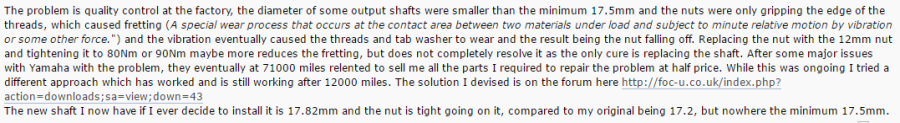

Re: Tightening front sprocket (no torque wrench) - Megawatt - 17-07-16 My apologies. Just reread your posts. My 2005 Fazer 1000 has a different nut to the failed ones. I assume the mechanism for failure is a manufacturing fault with the original nut.? Has there been any failures of the gearshaft threads? Re: Tightening front sprocket (no torque wrench) - darrsi - 17-07-16 . Re: Tightening front sprocket (no torque wrench) - fazersharp - 17-07-16 (17-07-16, 12:08 AM)darrsi link Wrote: [quote author=fazersharp link=topic=20572.msg237355#msg237355 date=1468709778] I was waiting for you :lol [/quote] Ta Dah ! Re: Tightening front sprocket (no torque wrench) - fazersharp - 17-07-16 Megawat - you need to fill out your avatar with the bike that you have and if it had said 1000 we could of said it was only the 600 that had the issue Re: Tightening front sprocket (no torque wrench) - Megawatt - 17-07-16 Thanks mate. I only have my phone and can't do much with it, but I'll have a go. |
