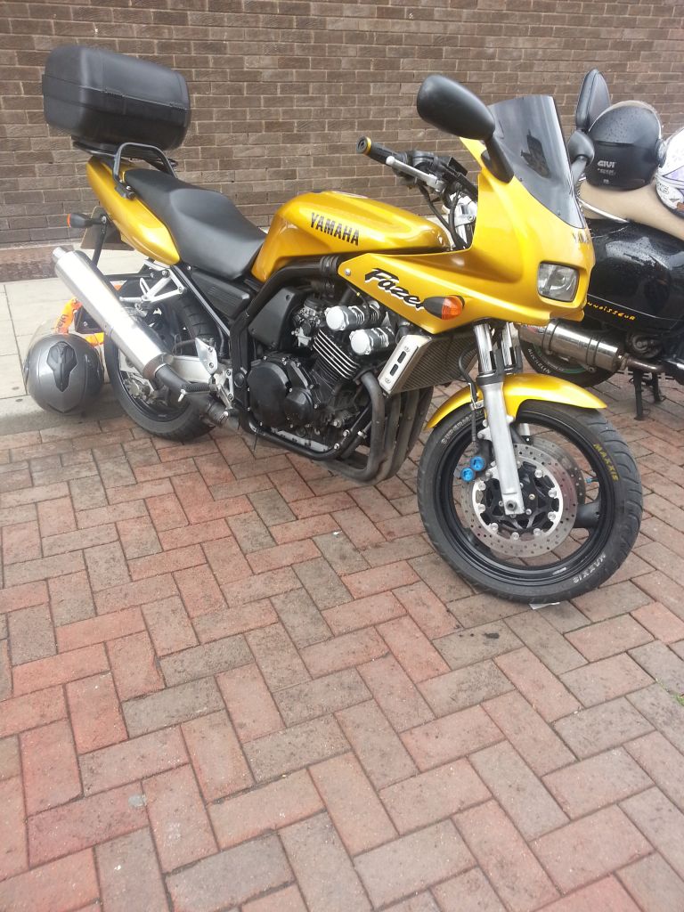

One air filter!
Trailer ''filtering''
Told ya I could filter on a trailer!!  :lol :lol :lol :lol

« Reply #56 on: 24 August 2013, 01:19:47 pm »
You need a topbox as well?!! Do you do quotes for a house removals service?  :lol

Special rates for Foccers!!  :lol :lol
I'm bringing stuff back to France from the UK for friends as well as all my clobber - so far, I've been asked for bacon, sausages, 60L of paint, and maybe half a Ford Escort.  :rollin
