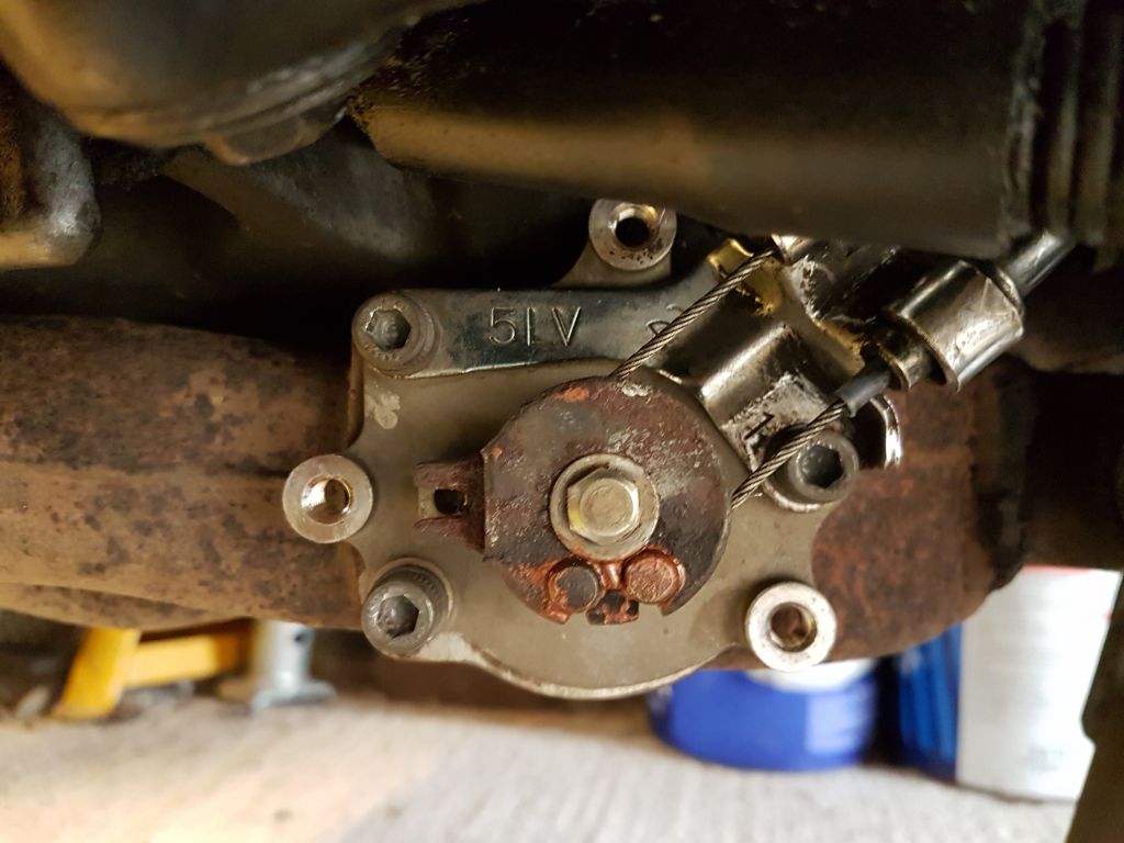

Does anyone know how the self-test turns the EXUP???
I imagined it would open it right up and then close it to the 'zero'd' position - with the tabs over the hole. Mine moves it from the zero'd position even MORE closed!!! It doesn't get very far because that's as far as the valve will turn. The self-test then fails and I get the 7k error displayed.
I've taken the cables off and the valve feels free to turn. I've freed the cables up so they have decent slack and the tabs line up over the hole (zero'd).
I usually do my own work on the bike but when I went to service the valve I discovered that one of the pulley plate bolts had sheared off before I bought it and I didn't fancy trying to drill that out of there so put it in to the local mechanic. When it came back the pulley plate bolts were good and the valve serviced but I now get this 7k error. Don't ask why I'm not returning it to the mechanic - it took 6 weeks and a ton of cash last time and it's not an experience I'm in a hurry to repeat.
Anyway, I'm now wondering if I need to adjust the cables further so the valve sits rotated in a more open position so the self-test can close the valve further - currently the test is driving the valve to it's fully closed position and failing - if I adjust the cables to rotate the valve to a slightly more open position the test can then close it further like it wants to...
But is that normal - for the test to start by *closing* the valve?? Like I said, I expected it to do an open-close cycle, not close-open-close - or whatever it is supposed to do...
The servo does start to open the valve when I rev the engine up (though I don't know at what engine speed as I can't watch the pulley and the rev counter at the same time!).
BTW, thanks Yamaha for putting the servo there - I hope I never have to get it out!!! I also found that the mechanic had disconnected the electrics to the coolant filler (temperature gauge??). Ah yes, that's why I do stuff myself...

« Reply #7 on: 27 April 2018, 04:20:07 pm »
the right way
the wrong way

« Reply #8 on: 28 April 2018, 01:38:45 pm »
So here's some interesting info that I haven't seen full explained in the Haynes manual, the Yamaha manual or any of the online guides...
I bet there's loads of Yamahas out there on the road with mis-adjusted EXUP valves because of this...
The EXUP control system has *two* reference points - I'll call them start and idle:
 - the start position is where the valve should be when the engine is being started up.
 - the idle position is where the valve should be when the engine is idling.
The start position - fork directly over hole.
The idle position - valve rotated (clockwise / opened) 30 degrees.
Here's the tricky bit - the valve should be adjusted to the start position but the EXUP control system only returns the valve to the start position when the ignition is switched on and the engine is not running.
And when the ignition is switched on the control system 'self-test' only returns the valve to the start position - it doesn't do any other full-deflection type of test movement. So if the valve is already in the start position it does nothing at all. It's not much of a self test really.
So, if you stop the engine by use of the run/kill switch or stall the engine the control system will zero the valve to the start position.
But if you have the engine running and switch the ignition off the control system is powered down immediately and the valve is left wherever it was (probably in the idle position). This is what my mechanic had done - the control system left the valve in the IDLE position and he'd then gone and adjusted the valve to the START position with the fork over the hole - 30 degrees retarded.
So my valve probably started off pretty well adjusted and the guy I paid to fix it adjusted it to 30 degrees more closed than it should be. Fortunately, it was so far retarded that when the control system tried to move it to the start position the valve actually hit its end-stop and wouldn't go far enough and the control system threw the 7k signal, other wise I'd have never known. Yeah, that's why I prefer to do stuff myself...
So, basically, all the instructions I've seen are incomplete or at least unclear - it is essential to have the ignition on for a few seconds without the engine running so the control system can set the valve to the start positon before you do the adjustment.
unfazed - you were right - gotta use the kill switch, not the ignition. When I see 'hit the kill switch' I tend to just switch the ignition off automatically but in this case it's gotta be the kill switch!

You are correct Roxburd, I also thought that the instruction in all manuals are a bit unclear.  :eek Even though Pats Site does state the on/off it is easy to get mixed up in the on off and running the engine, the kill switch method is just that bit more foolproof.  :D
If it is going to take a bit of time getting the adjustments correct it is advisable on the 2003 onward models and US imports to pull the plugs on the headlights to save the battery. Just don't forget to plug them back in when finished.  Very important also is to allow sufficient slack on the cables.

So I followed it - I turned the ignition on and the servo would move the pulley from 20 degrees ANTI-clockwise of the start position even further anti-clockwise against the valve's end-stop. The guide doesn't mention this. As I didn't know what the 'self-test' was supposed to do I didn't know if this was correct behaviour or not. The guide isn't clear on this specific aspect - it says "Turn the ignition ON then OFF. The pulley fork should now be aligned over the hole." Where should it start? Which way should it turn? Does it just go directly to the start position? I expected it to do a fuller end-to-end test to really check the valve can move freely throughout the range, not just move directly to the start position. Was this the cables 'improperly adjusted beyond the tension adjustment' (no, it wasn't) or was it a sensor failure or a failure in the controller?
The 'self-test' is actually just a reset to the start position with a fault signal if there's too much resistance. If the valve is already in the start position (as it would be if I stopped the engine with the kill switch then left it out on the rain in the back garden for 20 years) it doesn't even move at all - that's not much of a self-test really, is it? It's a great guide but if someone ends up in my position it's helpful to know the full picture, IMHO. It certainly helped me in my particular position - my cables weren't 'improperly adjusted beyond the tension adjustment' as Pat envisaged (and designed the guide for), they were improperly adjusted wide of the mark by 30 degrees by a mechanic who didn't know what he was doing.
If you already know what it does or you're just adjusting your cables a bit then Pat's guide is obviously all anyone would ever need, right? But if anyone finds turning the ignition ON and OFF just makes things worse and the pulley is moving in the wrong direction then I hope this info might help them realise what's going on. I guess that's why Pat posted his guide too... we're addressing slightly different starting points though.

Ah! So there's a curious thing...
My valve was noisy (rattly) and one of the the pulley plate bolts had sheared so I put in to the mechanic. He replaced some collars, a bush and a housing and adjusted the cables and charged me loads of money.
The valve did sound much quieter.
But the cables had been adjusted 30 degrees too far anticlockwise (valve closed). I adjusted them correctly. Now the bike is exactly as loud as it was before.
Adjusting the valve too far closed quietens it right down.
I wonder how many mechanics do that instead of servicing it...
So, my next question to the good folks of this forum - what should I do to quieten my valve down?
If what the mechanic has told me is true then he has already replaced the bush on the opposite side to the pulley. He didn't replace the bush on the pulley end because they was so much more expensive as you have to get the whole pulley plate, apparently. Obviously, I could replace the pulley-end bush/plate assembly now. How do I test whether it's out of service limits? Just measure the free movement, I guess.
The vale is only noisy when pulling away from a bend/roundabout at low road speed and low engine speed - my gut tells me that it might be end-float due to the bike being lent over. Yeah, sure, centripetal force should cancel the lean out but still there could be an end-float issue, right? Anyway, there's only three places it could be rattling - in the two end bushes and end-float. How would I measure end-float? Is it adjustable? I guess I can just bang in washers to take up and slack if there's no approved method...
Any advice much appreciated.

The Mounting plate can wear on the inside and can cause side play and a bit of noise, however it does not effect the operation of the valve. Mine is worn enough and has a ridge, but works fine. (40000miles). Last time mine was rattling it was because I had to much slack in the cables.
The bush in the mounting plate is very easily removed, but be aware it is pushed out from the inside. I remove them using a vice and either 9 or10mm socket (cannot remember which) on the inside and a 21 mm on the outside.  Bushes are around £45 each. It will do no harm to replace it. The plate is around £125
D'Oh! Too much slack in cables - that'll be the first thing to check then! Thanks, I should have thought of that. Haynes specification says 1.5mm cable free play (but not how it's measured) but the text says half a turn on each of the adjusters - I guess it's just a matter of finding the sweet spot really.
