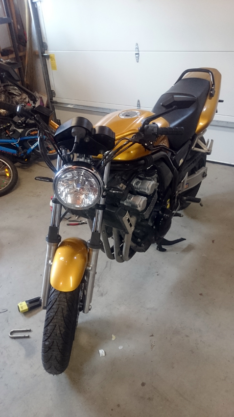

I'm mounting a single headlight, but how do i wire it so i can use high and low beam? I'm a noob at electronics 😰

If you take wires from one of the existing 3 pin connectors you will have hi/low

If you have an FZS600, do the dual headlight mod then just use the right hand bulb connector for your single light.

« Reply #3 on: 12 May 2017, 10:15:16 am »
Thanks guys!
All lights working now, just need to replace the big ugly speedometer and change the headlight to a new one.
But that´s next winter project so this will be my ride this summer.
Looking for a new exhaust, so that will be fitted during summer.
Also need to clean up my garage :-)

<img src="http://foc-u.co.uk/MGalleryItem.php?id=2995" alt="" />
fzs2
fzs3
fzs1

Hi! I did the headlight conversion first, easy peasy. Reused an old connector i had, now everything work great :-)
The bracket for the speedo is made out of some 3mm aluminium sheet, made some templates on cardboard first and cutted the aluminium with an hacksaw.
The speedo is so big and bulky so it looks kinda misplaced on a naked bike, but i´m looking for a new smaller one maybe from another yamaha ex. wrx 125.
