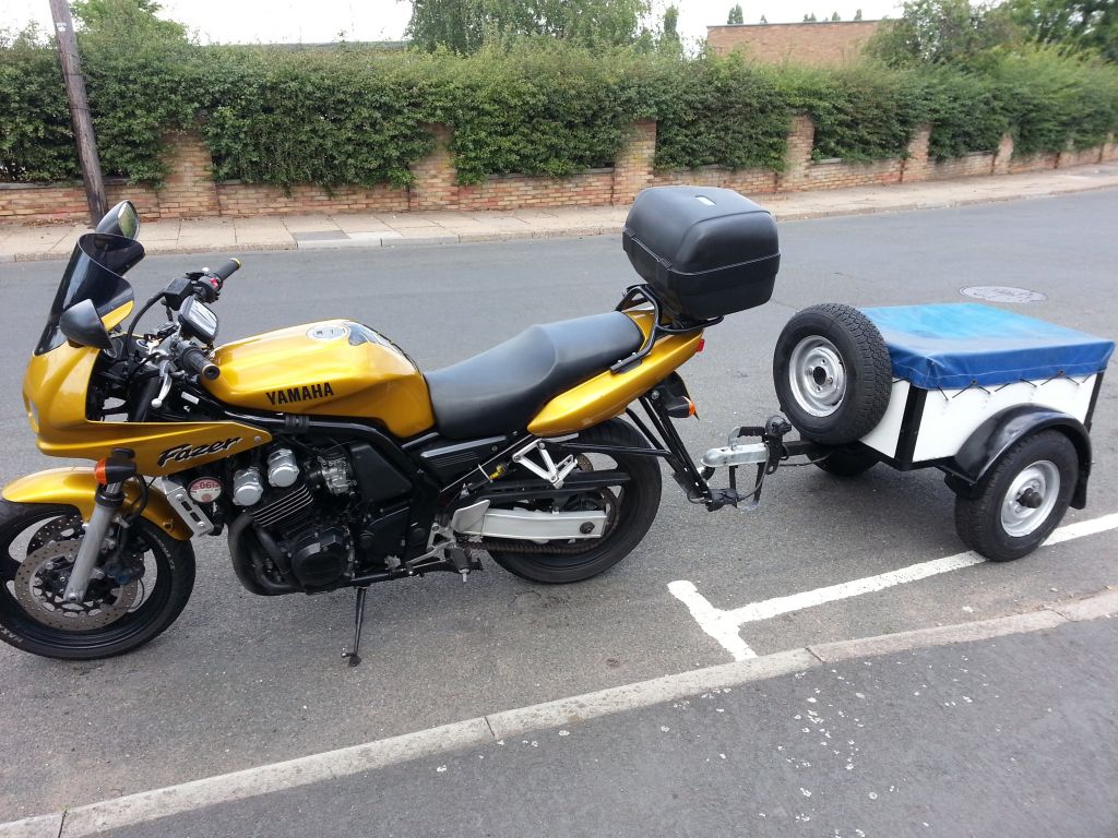

One air filter!
Trailer ''filtering''
Told ya I could filter on a trailer!!  :lol :lol :lol :lol

I'm bringing stuff back to France from the UK for friends as well as all my clobber - so far, I've been asked for bacon, sausages, 60L of paint, and maybe half a Ford Escort.  :rollin

It's galvanised steel - but lousy galvanising, has a few rust spots. Quite light, I'd say 40 / 50kg dry weight.
The trailer needs a few mods:
- Shorter tow bar (hitch to trailer body)
Couple of points though, I don't know what European law is like but are you aware of the UK laws? Max weight 150kg or 2/3 the kerb weight of the bike, but if its more than half I think it needs brakes.
https://www.gov.uk/towing-with-motorcycle
Also, max distance between the rear axle and the end of the trailer is 2.5m.
With this in mind I'd try to get it as close to 2.5m as possible, because that will minimise the angle the hitch moves through for a given change in height (i.e. bumps etc.). Think basic trigonometry.  ;)

Hope your mate can weld, both members will suffer fatigue due to the dynamix forces of tension and compression on each piece when accelerating and decelerating. Could try a further brace but you loose the flexability. You've said its heavy duty so good job then :) .
Close up pics on mount locations and have you tried it out yet?

Yeah, two members will be being pulled under acceleration, the other members will be being compressed. Then the opposite on each under deceleration.

It's about 2 metres now - and it's very hard to judge corners, as it sticks out so far behind me. The hitch will move more when shorter, but should make cornering a bit tighter. Again, many, many test rides are required!
Slimwilly - no - but it should!!  :lol :lol :lol
Red - it's unbraked, which is why I am so cautious with it on the back!
Fizzy - that's the reason I'm out with the trailer as much as I can - trying to familiarise myself with the handling as much as I can, and to inspect the welds! If they're too weak, I want to know BEFORE I'm halfway round the M25!
I'm getting there!  :)

News update:
- NOT shortening the drawbar (can still tow behind car now)
- Not turning the lid round
- Trailer now black
- Numberplate and wiring all tidied up
Shock news - we were tidying up the trailer, and looking for the kerbside weight plate, we made a startling discovery. My trailer is a classic!  :eek
The plate we found showed it was a VW trailer - built in 1963! With the shape of the trailer and the high suspension, we suspect it may be ex-German army!  :eek :eek :eek
