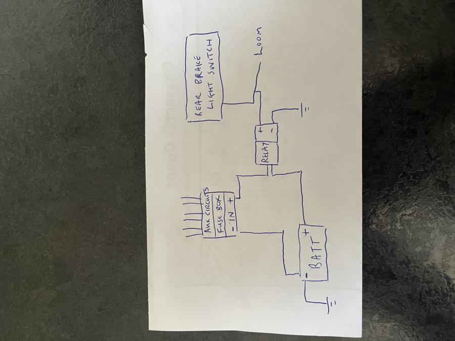

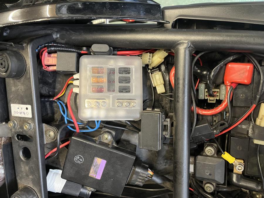

RE: Live 12v Feed for USB outlet - Trebus - 25-03-25
Maybe slightly overkill but my solution was to fit a small auxiliary fuse box under the seat. Rear brake light feed powers a relay with main 12v supply directly from battery.
I now have independent circuits for spot lights, usb charger and a 12v socket for powering my tyre inflator.

RE: Live 12v Feed for USB outlet - Trebus - 18-04-25
Picture and diagram attached. Hopefully makes sense!

(18-04-25, 02:26 PM)Trebus Wrote: Picture and diagram attached. Hopefully makes sense!
Fantastic help, thank you.
BSR67

I didn’t show it on the diagram but you want an inline fuse on the supply side of the fuse box as well.
