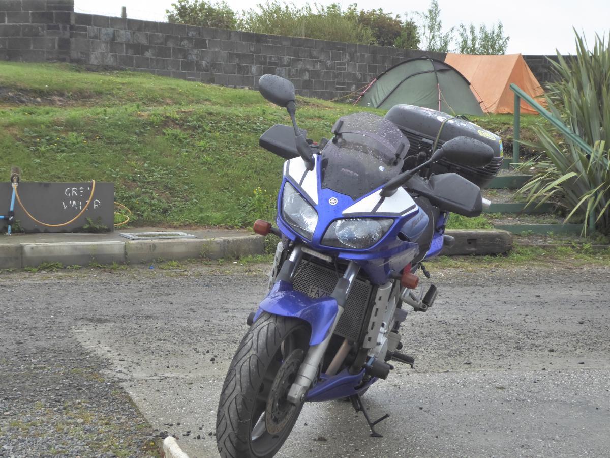

RE: Hand guards - Don71uk - 13-09-24
I’ve had these on my fazer for twenty years now, they were/are the old style Suzuki dl650 ones, they mount by a bolt on both the clutch and brake brackets, the bar end side is a c shape clip that just pushes onto the bar end weight, you my need to in large the opening a bit.

RE: Hand guards - fazersharp - 13-09-24
(13-09-24, 05:35 PM)Don71uk Wrote: I’ve had these on my fazer for twenty years now, they were/are the old style Suzuki dl650 ones, they mount by a bolt on both the clutch and brake brackets, the bar end side is a c shape clip that just pushes onto the bar end weight, you my need to in large the opening a bit.
Yes those are the ones that I looked at but on the boxeye the hit the tank on full lock.
