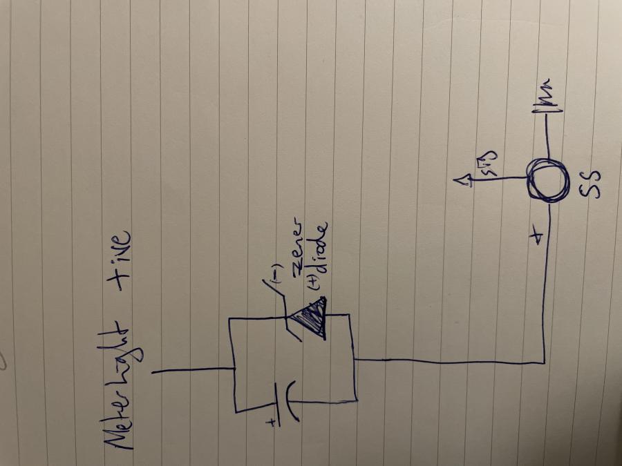

The circuitboard of the speedo connects the meter light input live (blue wire) back to the speed sensor output live (blue with yellow trace wire) via some kind of voltage regulator: In parallel there is a capacitor and a zener diode.
I’ll try and upload a pic of my half arsed circuit diagram!

Re: Speed sensor fusing: power / current requirements - FazerNoob - 25-05-22
Quick update for anyone in future looking for this issue on an fzs600 fazer speedo replace:
Summary: If you're replacing the speedo and keeping the original speed sensor it will probably work without this step, but I did it anyway.
- The speedo has this capacitor/zener diode combo between (a) the meter light input to the speedo (which is a secondary switched live) and (b) the speed sensor power output from the speedo.
- My previous diagram probably had the zener the wrong way round...
- I'm not clear what on it does. I'm pretty sure it doesn't reduce voltage. I guess it's either to (1) reduce "noise"/needle wobble on the speedo; and/or (2) to protect the sensitive speed sensor from voltage fluctuations.
- I expect that 25 years ago a talented yamaha engineer designed this feature into the circuit for a good reason anyway (let's hope he's now retired on company pension enjoying golf and warm saki...). I think these little details are behind the famous fazer reliability anyway, so how could I just bin it?!
- I couldn't confirm the specs for either the capacitor or the zener. So I bought an old wrecked speedo on eBay and cut them out and soldered (I'll add pics)
Side note on speedometers: The 1999 Fazer speedo is very different from the 2000 speedo. The circuit board is actually a completely different design with components in very different locations. I expect that they're probably 99% the same components wise. Future electronics tinkerers beware!
