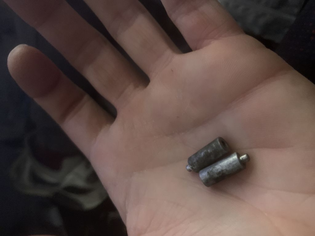

[color=rgb(68, 68, 68)]Hi everyone I rebuilt my carbs on my fazer just for something to do over winter.[/color][color=rgb(68, 68, 68)][/size]I have these parts left over. I think them was inside the spring that goes over the nut inbetween the throttle arms.I have checked the service Manuel, I even checked the spare parts catalog l… I cannot find  what they or where they go. I assume it was inbetween the sync screw and spring but they are definitely too tall. They definitely came from the bit inbetween carb 1&2.. the other is definitely from inbetween 3&4..First time working on any carbs ever so I’m in the dark.[size=19px][/color]

Did you split the bank or carbs into to separate units? What you have are the spacers between 2&3 used to maintain the distance between the carbs correctly when you tighten the side bolts. One is on the bottom  above the  float bowl on the engine side and the other is at the top below the black cover on the Air box side.

Ahhhh yes !!! :rollin  That’s what they are !!
Was giving myself right headaches  :'(
