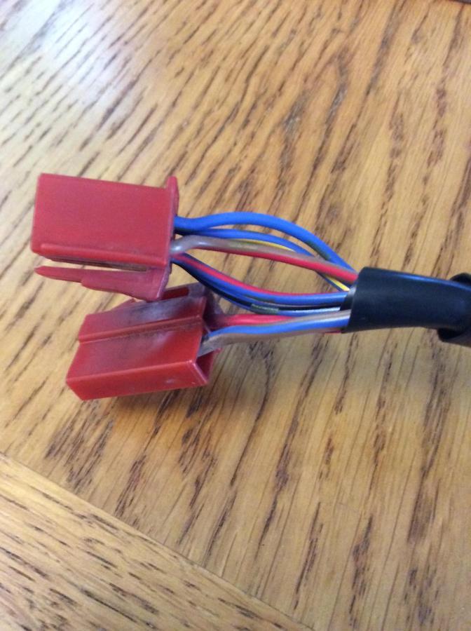

so the switch i have has 5 wires in one block and 2 wires in the second block. They look factory fitted not aftermarket or fitted by someone else. So do you think a post 2000 or a pre 2000 would still work? ill see if i can upload a picture.
Re: Yamaha fazer fzs 600 2003 model - neilr - 26-07-21
Hi I’ve attached a picture of the wires on my old ignition switch and the Haynes manual shows alarms fitted to 98/99 and 00/01 models. I’m very confused now?

Re: Yamaha fazer fzs 600 2003 model - Gnasher - 26-07-21
Here's your options the first contains how the blocks are wired, 6 wires.
https://yambits.co.uk/fzs600-fazer-ignition-switch-p-56183.html £49.99 the colours are a bit off but that's their drawing and the discription controdics itslef by stating 98 - 03 and 98 - 01 but there're all the same.
Or you can go YAM OE at £348.65 :'(
https://www.fowlersparts.co.uk/parts/4181631/fzs600-fazer-5rt4-2003-070-b/electrical-1
This is the wiring diagram for 03 FZS No 3 is the main or ignition switch, as you can clearly see 6 wires and to the left inside the dotted line the 2 connectors with wire colours.  Somebody has added an extra wire.

(26-07-21, 12:48 PM)neilr link Wrote: Hi I’ve attached a picture of the wires on my old ignition switch and the Haynes manual shows alarms fitted to 98/99 and 00/01 models. I’m very confused now?
Ignore it they're often wrong, I've never seen a factory fitted alarm on a UK FZS600.  Also look at the Haynes drawing top left ignition (main) switch there's 6 wires only from the plug.  At the end of the day it's just a plug and the wire will go nowhere Wink

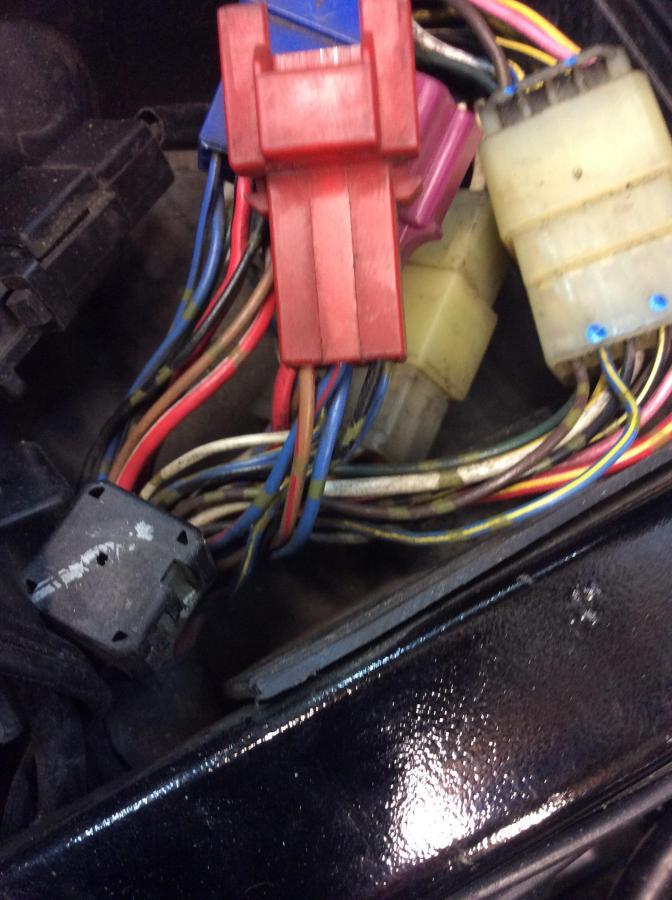

What the blue/black is doing in with the blue/red I've no idea.  It's been a while since I've work on an ignition switch on an FZS600, I can't remember seeing 7 wires, but possible.  How many wires in the female plug it plugs into?

Just added a couple of photos of the loom connections

Hi me again,
Have tried using one of these earlier model ignition switch but am having a real issue pairing up the correct wires. Can someone who's done this before please give me some insight as to what wire go where. I'm loosing what little hair i have trying to figure this out.
