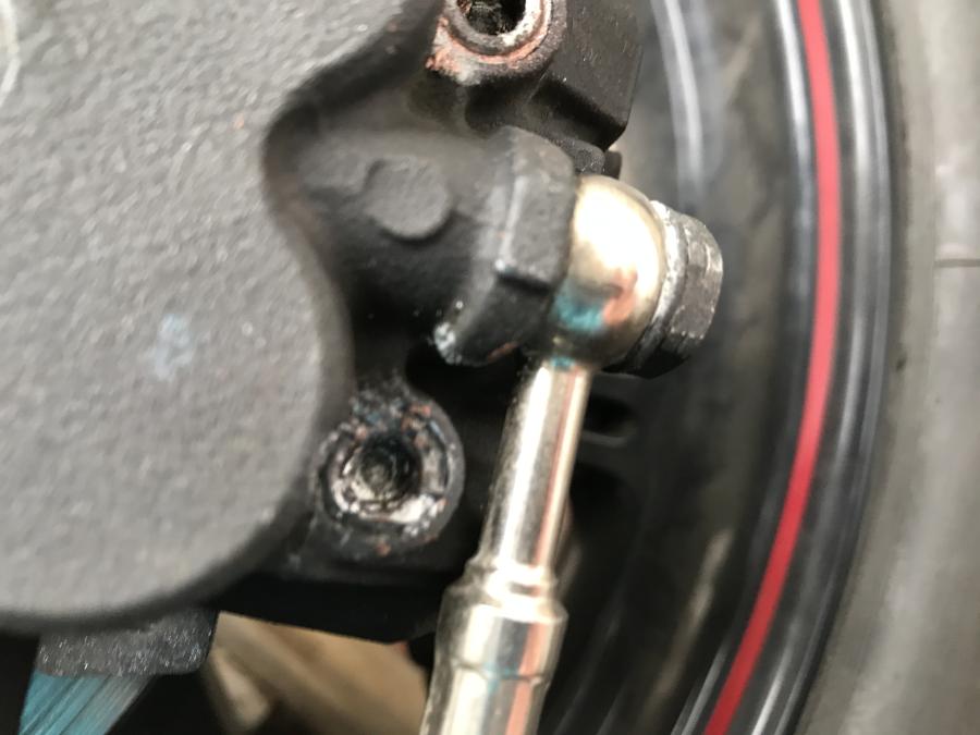

first thing to state this is not on my fazer but on my triumph bonneville but im sure you will offer your kind help whatever bike it is .
so i was intending to change brake pads on the rear today , got as far as breaking bolts before removing the caliper has two brake pins with threaded heads then shank so the threads are immediately after the pin head and part of the pin head, it sits flush (fully in ) with the caliper casting, its rounded to buggery now and i need a way to get it out. as it sits flush with the casting these is no access to any part of the pin head, its a 5mm allen head and not a lot of meat to the head beyond the allen head insert itself . so it not a good scenario , not protruding , not a lot of metal around the head and seized tight and rounded to buggery.
stating the obvious its the lower  in the pic , the other came out going back in for now copper greased etc
any help?
Re: rounded allen head brake pin - Trebus - 10-04-21
I’d be inclined to get the calliper off and cut the pads off the pin. Hacksaw or dremel etc. Then try and turn the pin with some mole grips. Maybe a bit of heat needed too.
Re: rounded allen head brake pin - FILZ6 - 10-04-21
+1 with Trebus. You could also try to tap a Torx into it if you have one that’s larger than the 5mm Allen key.
Re: rounded allen head brake pin - darrsi - 12-04-21
I wrecked the thread on my rear caliper years ago, and the reason why was because I used copper grease on the pad pin, then used a torque wrench trying to do things right.
The grease completely messes with torque wrench settings, especially when the setting is low, from memory around 10Nm.
So go easy when doing up the pad pins, they only need nipping up, and i would go very sparingly with the copper grease.
Re: rounded allen head brake pin - Gnasher - 12-04-21
The issues with these type caliper pins is two fold, 1 they use a too high strength thread locking compound, 2 it's cheap s/steal into aluminium. Added to that is owners/stealers over tightening them, which locks the taper (most have a taper), stretches the threads and using poor quality tools that wreck the allen screw i.e. round it off.
Normally heat will do it but as with everything there's heat and there's heat!  Most try and are successful using butane DIY plumbers blow torch, but these don't burn hot enough for the stubborn ones.  They just end up heating up the whole caliper, possibly wrecking the seals and not softening the compound.  What you need is acetylene just on the pin, either via the cap head (if there's room) or heating the pin between the body gap where the pads are.  It's so hot the heat goes straight down the pin and softens the compound in seconds, but not enough to damage anything.
The other way once the cap head is buggered, is to spot weld a allen key into the rounded off caliper pin, the heat from the weld softens the compound and the key which is now welded to the pin will with a socket get the pin out.  You don't need to attack things with Dremels, obviously you need access to acetylene and or a welder.  Both should be accessible at a local car workshop, just explain and if they give you funny looks, go elsewhere!
Falling the above, you can use easy outs, simple matter of drilling the centre of the cap head and using the easy out.  If that fails, its drill them out, by using a drill 1mm smaller than the thread hole in the caliper body, you need to be very accurate, so a pillar drill is required.  If you get it right you'll drill out the bolt but leave the thread in the caliper body untouched.  Run the thread through with a tap and bingo, new pin/s.
In all cases as mentioned take the caliper/s off secure in a vice.
Once they're out fit new and a little dab of chopper grease on the thread and tighten to the correct torque.
If none of the above works, which can happen, replacing the caliper is the cheapest option.
