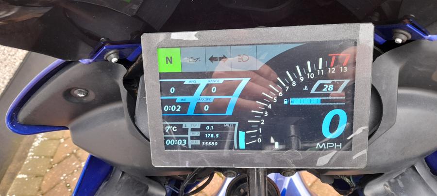

Any TFT Dash owners out there ! - Woodzey80 - 06-04-21 Hi ! Has anyone got one of these off danny ? If so are you happy with it ? Im made up with mine, the guy is a genius ! I do have a question though does your tpms feature on the dash work ? Cheers Graeme Re: Any TFT Dash owners out there ! - teecee90 - 06-04-21 I have fitted a multi-gauge but that's far enough for me... Have great admiration for the creator but I prefer the analogue clocks to a full TFT. Re: Any TFT Dash owners out there ! - old son - 07-04-21 I have the TFT dash and have been a bit of a guinea pig but every time I had an issue it was resolved very quickly and I think the dash has evolved as a result. I did have some issues with the TPMS system and the dash and sensors were sent back to Danny. His response was as follows and you may have the same issue: Just a quick update on the TPMS investigation...It turns out the protocol the kit uses is still the same, however what's changed are the Sensor IDs. In the previous TPMS kit, they were coded from 1 to 4 consistently. In the latest kit they are now coded from 0 to 3. The TFT Dash looks for sensors 2 and 4 ( LR and LF), although with your latest kit, sensor 4 wouldn't exist, and Sensor 2 is the incorrect sensor to use so that would explain why you've only seen one reading. In the next software update I will introduce a way to set the sensor IDs for the TPMS. This also means you'll be able to make use of all 4 sensors in the kit (just in case something happens to the first 2). I hope the above is helpful. If all else fails contact Danny. Re: Any TFT Dash owners out there ! - tex - 07-04-21 Mine works fine . A earlier version Re: Any TFT Dash owners out there ! - Woodzey80 - 10-04-21 Thanks for the reply old son. Dannys been great, even exchanged my tpms kit with one of his own but still no readings on my dash even after playing round with the id's. I'm hoping that it will somehow get fixed in a future update, apart from my small issue the dash is great & would definitely recommend one. Re: Any TFT Dash owners out there ! - old son - 10-04-21 Does anybody have a preferred screen colour which can be seen in bright sunlight. I am using white background and black numerals at the moment. Re: Any TFT Dash owners out there ! - Woodzey80 - 11-04-21 I've been using this one... Re: Any TFT Dash owners out there ! - old son - 11-04-21 Thanks, I've been using top left. I'll give yours a try. Re: Any TFT Dash owners out there ! - tex - 14-04-21 Just a quick one . Make sure the ignition is on when you install the sensors or it doesn't recognise them . Re: Any TFT Dash owners out there ! - Woodzey80 - 14-04-21 I will give that a go ?? Re: Any TFT Dash owners out there ! - Dinger1962 - 13-05-21 Hi bought a fzs thou with one of these fitted .been fine till I drained the battery and had to jump start bike .bikes running fine but no display .no idea who made it what make or anything.about it .supposed to be doing sc500 next Friday lookin grim Re: Any TFT Dash owners out there ! - Dinger1962 - 13-05-21 Any ideas would be appreciated thanks don't know where to start with it Re: Any TFT Dash owners out there ! - Woodzey80 - 13-05-21 You need to get in touch with Danny on this forum who makes them his user name is [color=rgb(63, 63, 63)]DJDLTD[/color] . Perhaps jump starting it has blew something in the dash !
