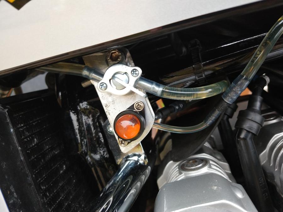

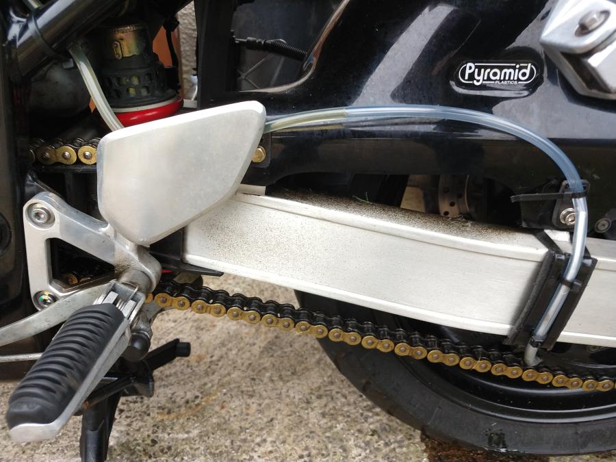

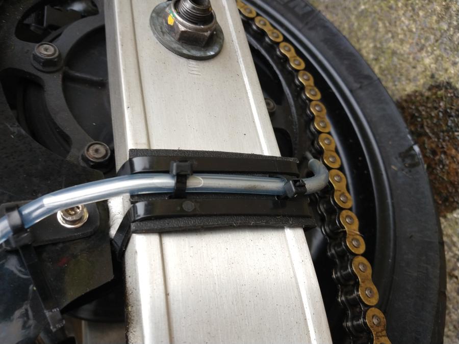

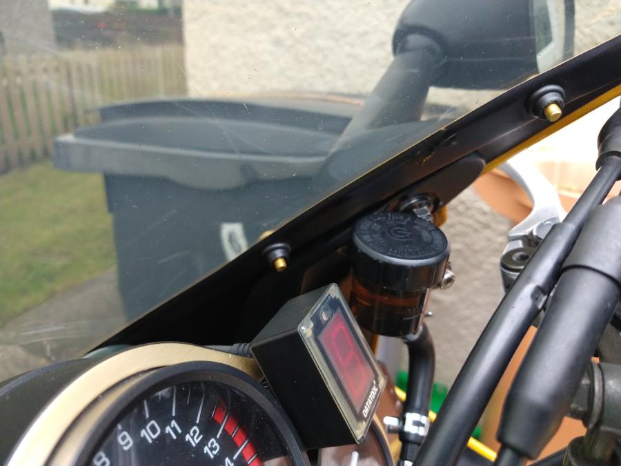

I decided to fit a chain oiler but wasn't prepared to part with the sort of money Scott and the likes wanted.
I designed by own and the cost was less than £20.
It comprises of a small brake fluid reservoir (mounted inside the fairing), a fuel tap and a primer bulb fitted to a piece of angular aluminium. This was then mounted on the horn bolt. The pipes were fitted using plastic sourced from a busted old top box I cut up for the project.
I'm using 15w40 engine oil at the moment and a couple of pushes of the primer bulb is more than adequate to lubricate the chain.
I might tidy up some of the fittings when I find the time.

Nice work.
Does it oil both sides of the chain though, i can't quite make it out?

From what you've written this is an open circuit, i.e. the flow is only controlled by the fuel tap, which in turn flows though to the bulb.  What's stopping extra flow?  If something fails you are going to dump all the oil in the system all over the back wheel and looking at the size of the delivery pipe that's not going to take long :eek I can already see evidence of this in your 1st and 4th picture, from where you've been experimenting I assume.
You might want to give this some further thought before you go riding around  Wink

Re: Chain Oiler. - 7omly - 23-09-20
At present it only works on one side but I have plans to use a 'Y' piece pipe splitter to eventually feed both sides.
With regards to dumping the contents onto the back wheel, I'm not saying it couldn't happen but previous evidence shows it is highly unlikely.  I fitted the same system to my previous FZS600 (I foolishly sold it but that's another story) and I never had a problem with it.
I turn the tap on and give a couple of pumps on the primer bulb and wait for 20 seconds of riding and then turn the tap off.
As you rightly say there is evidence of my experimenting but to be honest I was so pleased with my handiwork that I pumped the primer bulb four or five times which is excessive hence the puddle.
I don't leave the tap on constantly as there is really no need.
The last one I made was on my old Fazer for around five years and around twenty thousand miles.
As for worrying about the tap failing it would be interesting to know the MTBF for motorcycle fuel taps. I've done around twenty five miles so far and only needed to use it once and there is no leakage with the tap closed.
As for the Loobman they are good value for the money but a bit flimsy. I had one fitted to a diversion but the reservoir had a plunger type valve that failed after only 15 months.
Thanks for the concern and interest. I will keep you updated with an honest appraisal of how it operates, faults and all.
