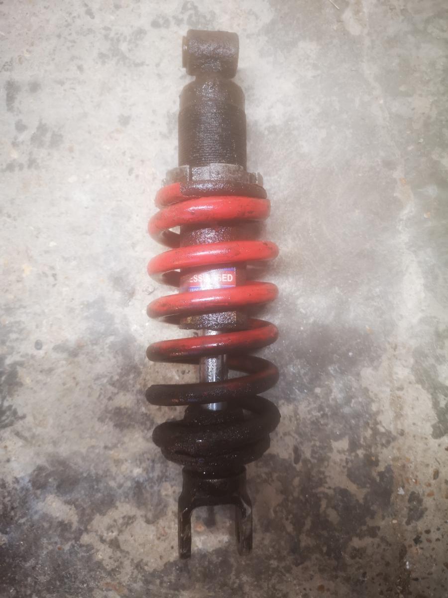

rear shock replacment - philb - 19-09-20 just got myself a 2001 FZS1000 looking at getting the suspension updated front forks to be stripped and serviced, new spring and re-valved ect, rear shock has a few options BMW s1000rr shock or new YSS shock with spring to match my weight but not sure what these units are like what option would you choose? if front forks come back cheaper to do than i ve put away i'll go for new nitron shock Re: rear shock replacment - b1k3rdude - 19-09-20 The rule of thumb when it comes to YSS, is never ever fit them unless your desperate and absolutly need the bike on the road. Even then dont fit one, just buy a low mileage OEM shock it will be far cheaper and actually work better. (I have a OEM in good condition with I think 15k on it - http://foc-u.co.uk/index.php?topic=26308.msg317300#msg317300) If some one on here has the BMW shock and thier weight is similar to your then unless someone corrects me, I would say thats a safe bet. Another option is see if anyone has a Devilsyam R6 modded shock £200-300. Or lastly if you have the cash there is an Ohlins with tool-less adjustable pre-load for sale on here £500 - http://foc-u.co.uk/index.php?topic=26390.0 Re: rear shock replacment - bigfootpete - 30-09-20 I fitted an Ohlins shock with a mate years ago - got it from E-bay for a reasonable price. Right pain the backside to fit when you have large hands, much better than the OEM shock as you would expect though. I've rarely adjusted it or had it serviced since fitting though - because I'm lazy... Re: rear shock replacment - ProdigalSon - 22-11-20 So it's been a long time since I've been on here and I don't know if the person who bought my Gen.1 is on this forum but I fitted the 2011 BMW S1000RR rear shock to my bike and it was excellent, especially given that I only paid £100 for it in excellent condition. You have to drill the bottom fork hole out if I remember correctly to accept the stock Fazer bottom bolt, some have put extra washers in the top mount but I had a friend who made me new top hat bushes. I put a post up at the time you should find it on a search, the best £100 I spent on my bike. Re: rear shock replacment - clunkie66 - 27-11-20 Has anyone had any difficulty fitting a Nitron road shock? Re: rear shock replacment - Gnasher - 28-11-20 (27-11-20, 11:16 AM)clunkie66 link Wrote: Has anyone had any difficulty fitting a Nitron road shock? No, fitted a good few over the years, great shocks. There's 3 types NTR 1 - 3, each number represents damping adjustment, 1, 2 or 3 way, cost goes up with each, all can be fitted with hydraulic preload adjuster at extra cost. All are built to suit you and your riding style when buying new, if you buy second hand, check if possible what they had the shock built to or it could be too soft/hard to suit you. That said it could be rebuilt to your spec. My advice if your planning on keeping the bike buy new, direct from Nitron using their website. These are the best replacement shocks out there in my opinion, even the base version is 100 times better than OE, R6 or BMW, as good as Ohlins this side of a track, half the cost like for like and it's British ![]() Re: rear shock replacment - b1k3rdude - 28-11-20 Morning Clunk Using the search function would have helped you out fella, I did a quick search for the word nitron. There are a lot of posts, but PieEater appears in a few of them as I believe he has fitted one. So he is well placed to answer any fitting questions I would think.
