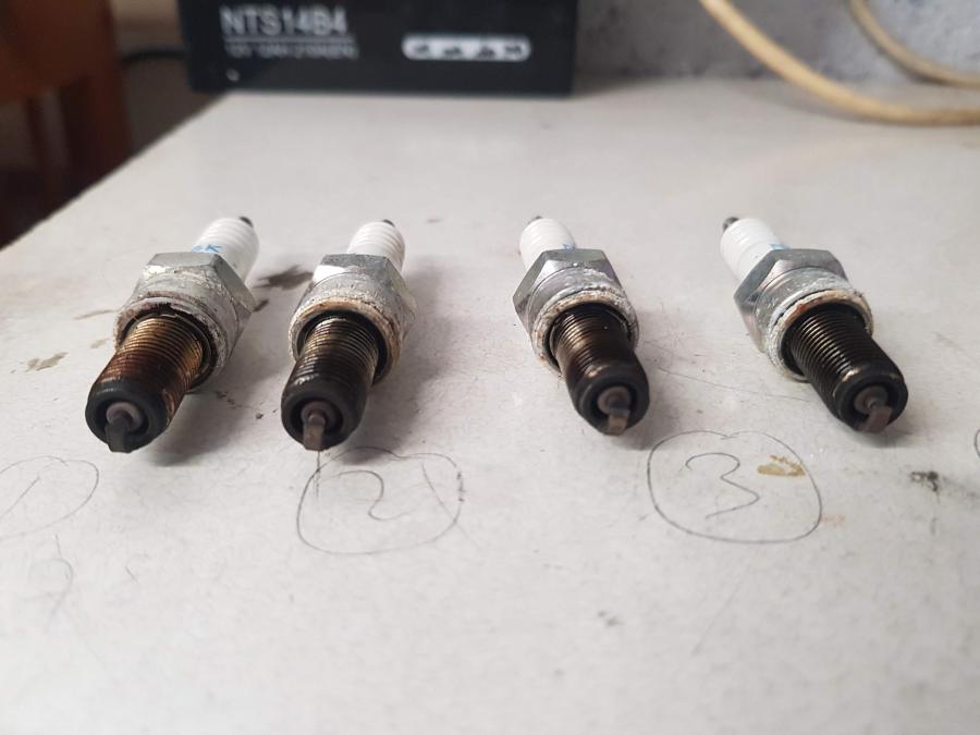

is my gen 1 running rich - blackcabbie - 08-08-20

Re: is my gen 1 running rich - blackcabbie - 08-08-20
yep it was ivanised 15 years ago by mike gtx...... not full monty though....... is there any adjustment on carbs to lean it out a bit......end can exit looks a little bit sooty as well....... just come back from a 1400 mile 6 day trip to scotland on it...... it did run faultless though....

Re: is my gen 1 running rich - YamFazFan - 08-08-20
Those plug electrodes look about right tho don't they?. I thought all the carb engine Fazers ran slightly on the rich side. You often hear 600 owners say that they don't need any choke on cold starts. Assuming Ivanising has a deliberate enriching effect, wouldn't you just be tampering with that by trying to lean it off?.

(08-08-20, 10:50 PM)YamFazFan link Wrote: Those plug electrodes look about right tho don't they?. I thought all the carb engine Fazers ran slightly on the rich side. You often hear 600 owners say that they don't need any choke on cold starts. Assuming Ivanising has a deliberate enriching effect, wouldn't you just be tampering with that by trying to lean it off?.
Agreed. I’d replace the plugs and leave it well alone if running OK
Re: is my gen 1 running rich - The Male Whale - 09-08-20
Looks OK - when was air filter last changed?

Re: is my gen 1 running rich - blackcabbie - 09-08-20
it had a air filter about 4k miles ago...... if you all think its ok , thats good enough for me...... i just expected the plugs to be a bit more on the brown side of black....... the only reason i took them out to check was because the end can exit pipe looked a bit sooty....... its running ok though, all be it a bit juicy on the mpg ....

My first Fazer post Ivanising by Mike GTX had textbook brown plugs and I could avg 50mpg two up and spanking it.
My second Fazer also Ivanised by Mike has black plugs much like your photos and a sooty end can. So like you I think it is a little on the rich side even with a K&N air filter.

Re: is my gen 1 running rich - Falcon 269 - 15-08-20
I'm still checking in from time to time but currently rather preoccupied.  Father had a stroke back in April and we're over in the UK caring for him since his discharge from hospital.
The pilot jet, needle and main jet influence on fuelling is cumulative rather than separate.  As the throttle is opened, the needle profile and main jet size take precedence but fuel still flows through the pilot jet and the idle mixture screw setting still has some influence on the a/f ratio at mid-full throttle.
I found that if you tend to ride mostly on part-throttle and keep the revs below 6-7k rpm then the plugs will be more likely to show blackish and there will be some sooting around the exhaust outlet.
Although Ivan recommends 4.5 - 5 turns out on the mixture screws, I settled on 4 - 4.25 turns after a few years of doing his kit installations.  Ivan also says it's optional to enlarge the second bypass hole.  I favoured just enlarging one hole - it didn't seem to make any difference on performance but reduced the tendency to run too rich at idle.
While plug colour is a guide to fuelling, it doesn't tell the whole story.  Anyone who remembers doing plug chops on 2-strokes will understand what I mean. Smile
The plugs in the OP's photo are much like mine were and I would call them typical of a Full Monty installation.  You could spend time and money on a dyno trying to fine tune the mixture screw setting but I suspect it would make only a marginal difference.  Is it worth the hassle and cost to strive for an ideal a/f ratio at the very bottom end of the rev range/throttle position?  I don't think so. Smile

Sorry to hear about your father mate, very best wishes.
This is sound advice as ever from Mike.  All you're doing is trying to chase a very small error for very little gain at a fair bit of cost.
Providing the bike is running well and fuel consumption isn't increasing, it's fine.  2 stroke plug chop, now there's a blast from the past, K&N's, expansion chambers, box of jets, I could get the carbs off the RD swap the mains and/or needle height, back on in about 20mins, not so easy on the H2 and triple GT's mind :rolleyes
