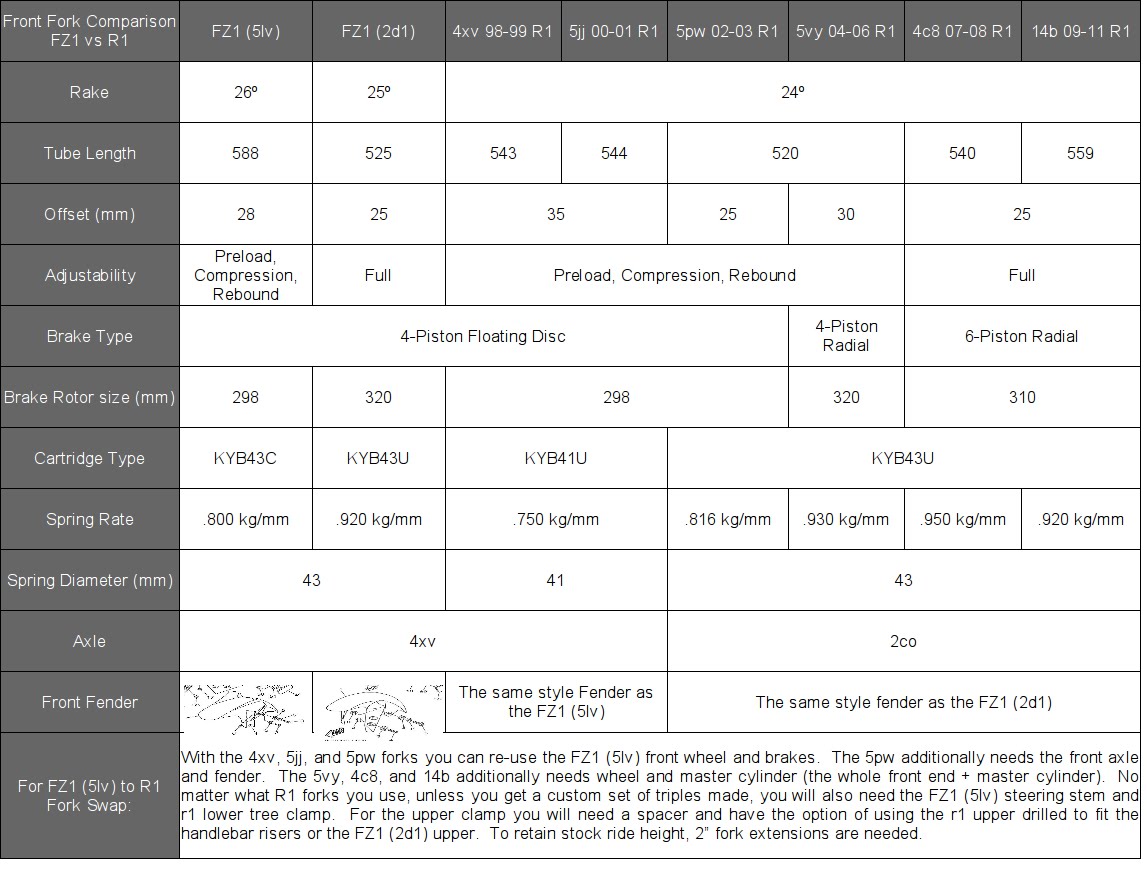

Absolutely, i have a doc found online with all lengths, offsets and rakes for all years of R1 forks compared to the FZ1. I put a 2003 fork on my TRX way back and one should always know that you change rake and wheelbase etc when doing stuff like that.

From memory, 4XV forks are one of the longest sets you can get, whereas 5VY are one of the shortest?I found that even with 4XV there was a fairly noticeable front-end drop.
Re: R1 fork mod Can the later forks with Radial calipers be fitted? - killerwhaleTRX - 08-07-20
(07-07-20, 07:28 PM)kebab19 link Wrote: From memory, 4XV forks are one of the longest sets you can get, whereas 5VY are one of the shortest?I found that even with 4XV there was a fairly noticeable front-end drop.
Found it:
http://1.bp.blogspot.com/-GS-sydb2h1g/Trs61bA76EI/AAAAAAAALfw/qEfZD5MB55E/s1600/r1+fork+comp.png

From a yoke perspective, they are mechanically similar, except the offset. As long as the forks fit in the yokes - 54mm bottom yoke and 50mm top yoke (if I remember correctly), you should be fine.
As for the forks themselves, using 4XV / 5JJ forks, you can use the original Fazer axle, wheel & brakes.
With 5PW forks, you’ll need the 5PW front axle, but the original wheels & brakes can be used.
With later model forks, (5VY onwards) you’ll need the complete axle, wheel and brakes, and master cylinder (?). Because of radial type brakes and different size brake rotors
The various forks have different lengths, all of which are shorter than the original fazer (588mm). So its always going to be lower at the front, no matter which forks you use – just a question of how much lower.
5XV & 5JJ are about 544mm. I think they are the longest of the R1 options.
5PW & 5VY are about 520mm.
My collection of info may not all be correct, so happy if someone could confirm.
