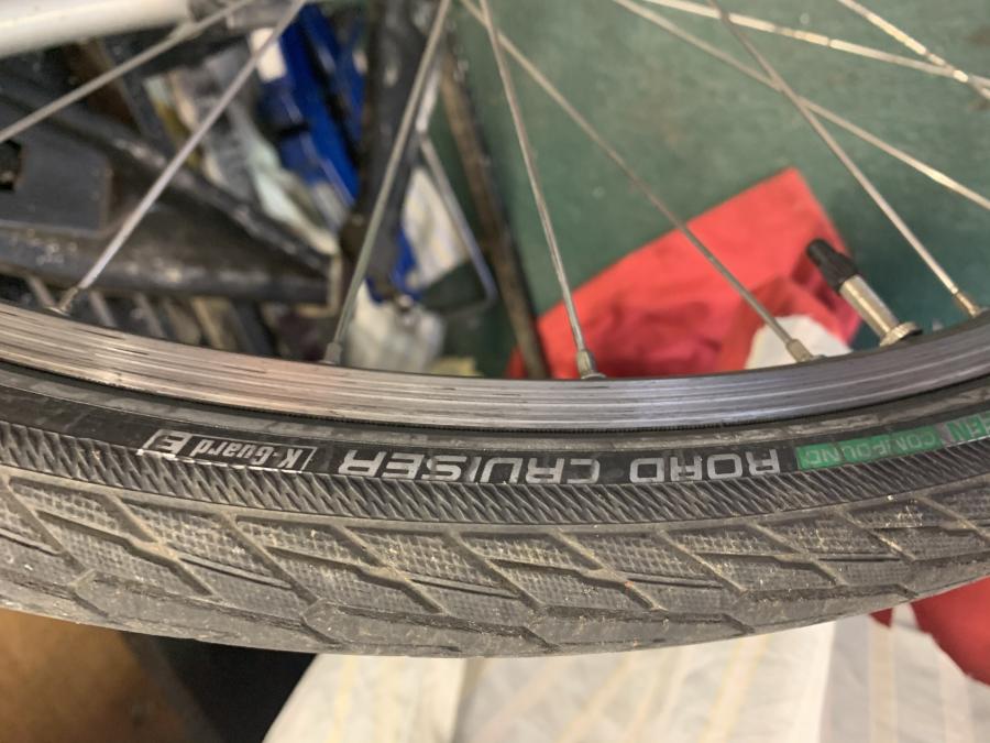

The road cruisers seem a good compromise between road and trail use and don’t make much noise like mountain bike tyres. With my old tyres I kept getting punctures but these have K-Guard which is meant to be a bit tougher.
Re: Focer font of knowledge Cycling - Trebus - 22-06-20
Here’s the tread on the road cruiser.
