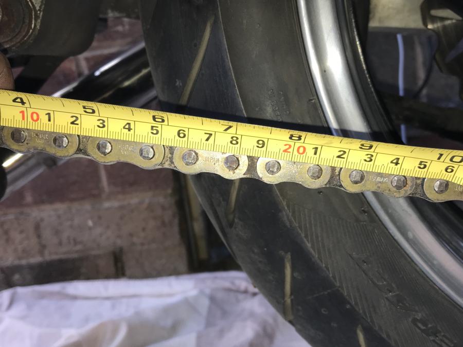

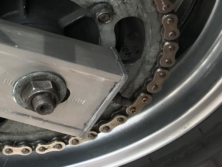

Hi all. Some advice please. I’ve recently picked up a 1998 fSZ600 with 24K. What would be your thoughts on this chain? I know the manual says 150 mm max. Also there are two points like the one in the below picture where there is clearly a chain link I was expecting there to be only one. There at two points like the one at the rear sprocket both on the same side of the chain. Is this ok and and I correct to presume that they are the connecting points.
Re: Chain advice - markbarker2000 - 15-06-20
This is the additional pic
Rear sprocket.
Just thought I’d add too the sprockets both look good with little wear in them.

I'm not quite sure what your picture is showing us, if it's to show there's two separate joining links, I can't really see them not even one if I'm honest.
Endless chains such as what Yamaha supply or fitted as standard have a pended end rivet, the shape of which are a square with 4 bevelled edges, the pictures shows only this type of links.  The joining links supplied with non endless chains, which make up the vast majority of replacement chains are expanding pin type, this type is seen in your picture of the sprocket and is located at 3 O'clock position.  Yes you can get factory type rivet joining links, in the replacement non endless chain kits, but these require a special anvil tool which is very, very expensive, time consuming and very tricky to use in the vertical position while the chain is on the bike.  These are used in my experience, when making up endless chains before there are fitted, to custom or drag/race machines with non standard swingarm lengths, not when doing routine servicing for road bikes, in which case the expanding pin type link is used.
I've fitted many chains both endless and the more common non-endless chains over the years.  I've never fitted a pended factory link to non-endless chain while the chain is on the bike and I don't know of a stealer doing it either, it just too difficult, too expensive and time consuming 99.9% will be expanding pin links which are perfectly acceptable.
Using your pictures as a ref, the chain is out of spec and needs to be replaced as it's over the 150mm length over 11 pins.  Another fairly reliable method and is alluded to in another post, is pulling the chain off the rear sprocket and being able to slide a pencil in the gap.  Another way is trying to push a link together if you can feel movement (slight knocking) the chain is buggered.

There's a link next to the bolt on the right of the swingarm in the picture. The other one is out of shot. Doesn't look like it's been splayed enough to me, but i agree everything is pointing to changing sprockets and chain, for peace of mind if anything.
Re: Chain advice - Gnasher - 16-06-20
(16-06-20, 10:29 AM)darrsi link Wrote: There's a link next to the bolt on the right of the swingarm in the picture. The other one is out of shot. Doesn't look like it's been splayed enough to me, but i agree everything is pointing to changing sprockets and chain, for peace of mind if anything.
You mean the one I stated
Quote: this type is seen in your picture of the sprocket and is located at 3 O'clock position.
It's fine, the big mistake stealers and DIY owners make is too over splay/rivet them, which leads to a tight link.  The fit between the side plate and the pins is tolerance, it requires very little to lock them.  Tight joining links are the cause of many replacement chains failing, I've replaced, replacement chains in less than 3k.  Trouble is you the owner trying to prove you've oiled/lub it etc etc.
My advice, always check the joining link by hand before you ride off, it's it not the same as the other links i.e. to lose/tight it's fitted incorrectly.

The other link is here. Sorry I didn’t include it in the first set of pictures. You are correct to see that the other link is at the tensioning bolt on the back sprocket.
The pic I’ve put of the measurements show that the ten link section is 154 mm and not 150 as stated in Haynes.
I was just looking for consensus regarding the state of this chain. I’ve tensioned it properly and it doesn’t lift off the rear sprocket at all.

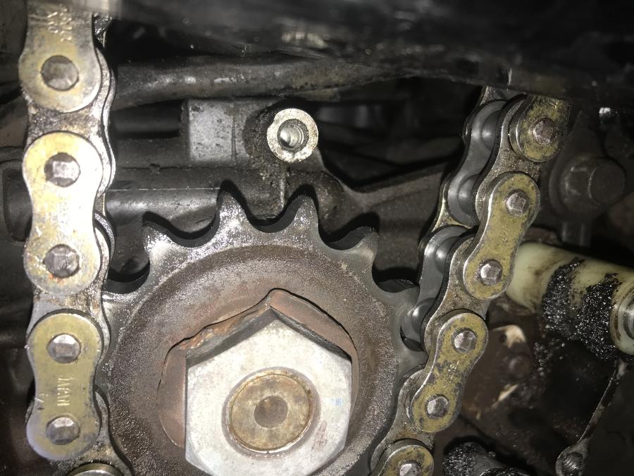

I’ve just taken two pics of the sprockets too to see what people think.

Rear 1
Re: Chain advice - markbarker2000 - 16-06-20
Rear 2
Front

It may be the shadows but teh sprockets both look like they are starting to "hook" so would need to be changed. Also the picture of the chain on the rear sprocket makes it look like you can see the bottom of the teeth under the chain also meaning its worn.
Re: Chain advice - Trebus - 16-06-20
Front looks more worn but not unusual, it will obviously rotate approx 3 times compared with rear. In the past I’ve changed just the front On other bikes when on a budget but ideally change both and chain at the same time.

Both sprockets and the chain need replacing.
150mm is the maximum serviceable stretch tolerance, yours is 153, the front sprocket is hooked, the rear is worn.  Many owners make the big mistake of not changing sprockets when the chain is replaced, it's bad practice and false economy, worn sprockets will half the chain's service life.

Not sure what I am looking at but the front sprocket looks like the centre is domed in the picture. If that is the case then it also looks like it has the old 9mm nut, so when changing the sprocket it will need the 12.5 nut. http://foc-u.co.uk/index.php?topic=24665.msg288535#msg288535
