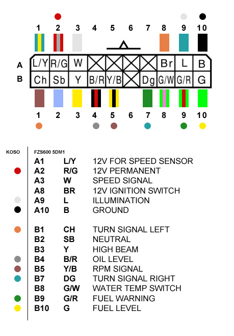

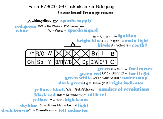

Want to fit new clocks - 74eldiablo - 29-01-20 Its been a while since i was last here, bikes been laid up since oct 1st and cannot come out to play till mar 1st (winter tyre rules) anyway whilst generally looking and dreaming of spring/summer 2020 i've decided that i would like to update my original clocks and slim down the cockpit for a cleaner look. My thoughts at this point are: find some yamaha lcd clocks (rpm 12k) and see if they can somehow be fashioned into the existing clock loom, Or Buy a set of koso copies / other lcd speedos off the bay around £40. Is it possible to wire up the fuel guage from analogue to digital? How do i wire up the speedo sensor (both options) Can anyone help me in regards to this who has already done this?? What colour wires from yamaha original loom to new speedo, pics would be ideal. Cheers foccers Re: Want to fit new clocks - matt7chunk - 29-01-20 I'm sure disorderly punk will chip in here at some point , I'm sure he managed to fit a Koso copy on his Fazer ? Many send him a PM Re: Want to fit new clocks - 74eldiablo - 29-01-20 Ok i'll send him a stamped addressed envelope ![]() Thanks Re: Want to fit new clocks - mobile mouse - 30-01-20 Hi all, I watched FortNine on YouTube see https://www.youtube.com/watch?v=q_XAiydgOQg jump to 3:40/9:18 this looks an interesting display replacement.... And you can get one of the models on amazon uk. https://www.amazon.co.uk/Trail-Tech-202-704-Endurance-Computer/dp/B007NNJKCG/ref=as_li_ss_tl?keywords=trail+tech&qid=1561143421&s=gateway&sr=8-1&linkCode=ll1&tag=fortnine-21&linkId=e292f3dc6257eeebac441d49cb7585ab&langua The voyager pro looks great but a bit expensive at £575 http://www.trailtechproducts.co.uk/acatalog/Voyager_Off_Road_Motorcycle.html Re: Want to fit new clocks - Disorderlypunk - 02-02-20 for anyone else in the future koso wiring into fzs600 connector <img src="http://foc-u.co.uk/MGalleryItem.php?id=3385" alt="" /> all the fzs connections <img src="http://foc-u.co.uk/MGalleryItem.php?id=3386" alt="" /> Re: Want to fit new clocks - unfazed - 02-02-20 (02-02-20, 12:08 PM)Disorderlypunk link Wrote: for anyone else in the futureUpload them to the downloads section, would make it easier for people to find Re: Want to fit new clocks - 74eldiablo - 03-02-20 Mucho gracias senor disorderlypunk ?? |
