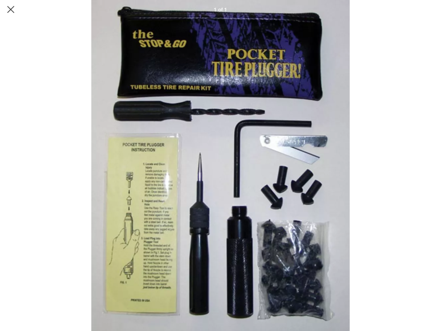

Re: Puncture repair kits (Roadside) - robbo - 18-01-20
+1 for the Stop'n'go. No glue to mess about with. Has got me out of trouble on two occasions. You could either carry sparklets to get the tyre inflated, then go to a garage to fully inflate and check the pressure. Or do as several members do, and carry as small 12v pump, which can be plugged into a cigar type lighter, an optimate lead, or clipped across the battery.

thanks for feedback had a good look at all the vids n reviews and the stop n go 6000 with pump looks like the way to go.

A couple of years go, the local IAM Group did a session with Russ Tappenden of Russ' Tyres down here in Portsmouth to try out a bunch of these kits.
We found that, after several different tries, the Stop and Go kit was by far the most reliable out of all the ones we tried which included the "sticky cord" and Cargol "Twist and Go" versions.

When we tried it out a couple of times, on one attempt it didn't plug the hole properly and was the equivalent of a slow puncture. It probably would have got you home ok if you'd kept the speed down and weren't going too far, but it was only a temporary fix*
Also, of course, it only works on round holes, if they're elongated or oval, it wouldn't work.
* I would put the usual caveat here that any roadside repair is only a temporary fix until you've had the tyre checked properly as there could be damage to the inside of the carcass that isn't visible.
Oh and if you have the FZ6, it's *really* not a good idea to put the CO2 cylinders under the seat as it can get rather warm with the under-seat pipes and they have a recommended safety temperature of 50 degrees!
I've bought one of the little pumps which I can connect up to the Optimate charger lead :thumbup
