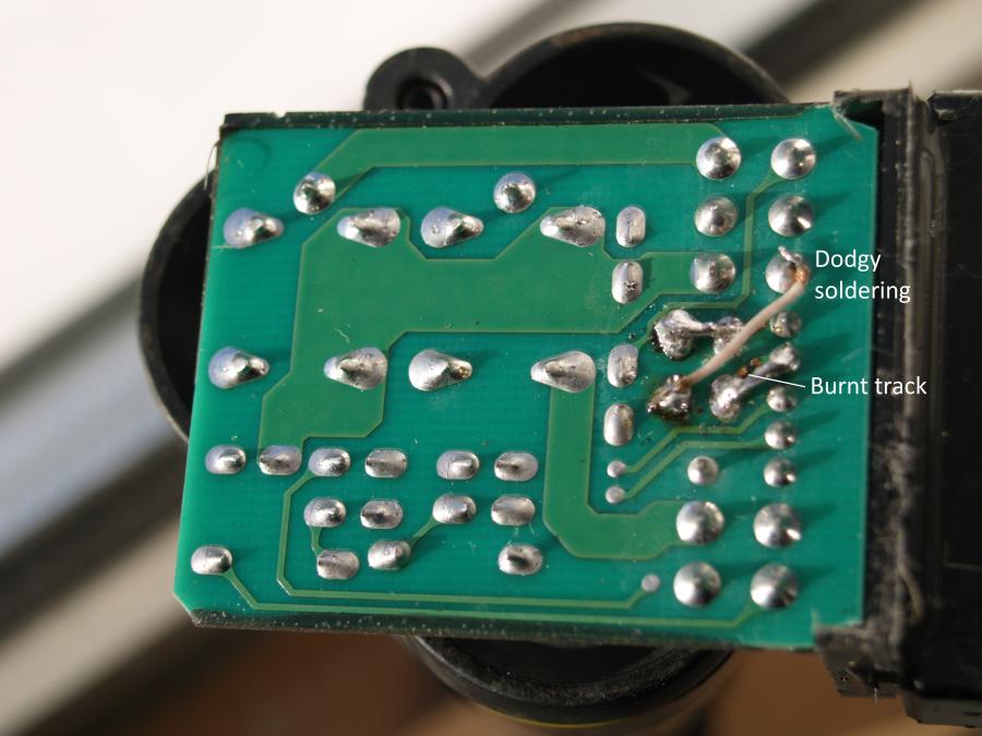

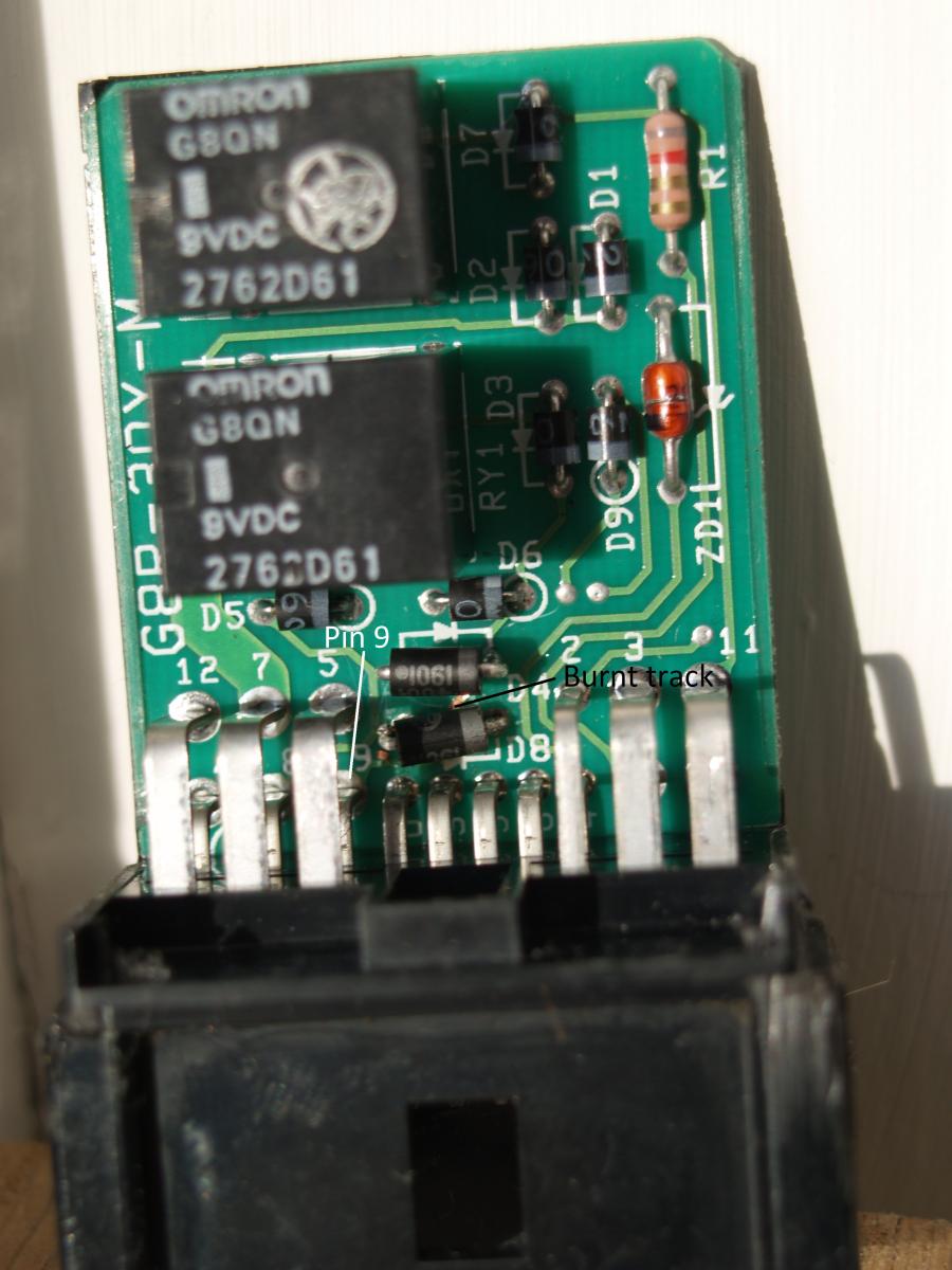

Hey your Dudeness ! I thought I'd like some pics for posterity so untaped the spare one and got snapping. Sending them to you as you were decent enough to show an interest.
Glad I did. Found a dodgy bit of soldering. See attached pics. I replaced D4 and D8 with 1N1004 type diodes; a bit beefier and just fit. One buggered track on the component side can be seen running from the cathode on D4, under D8 to pin 9. It is cooked under where D8 is. Flip it over and you can see the repairs and the 2nd burnt out track runs to pin 13. The failed bit can be seen right next to the repair.
This was the prototype. The second one is a lot tidier and is fitted to the bike but I ain't untaping that ! Cheers.
