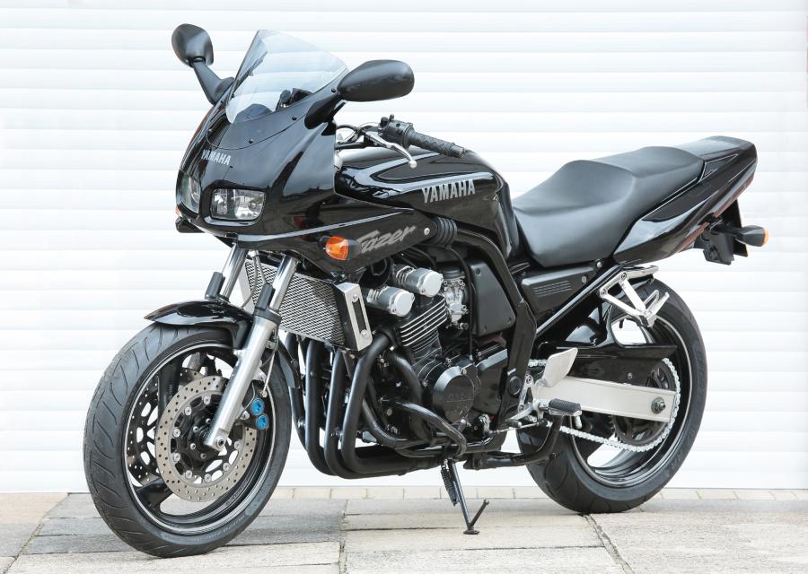

Filling holes in plastic Bodykit / panels - Rear pillion handles - F4celess - 30-10-19 Need some advice please on the best methods for this. So I've removed the rear pillion handles on my Mk1 Fazer and am left with 2 round holes, about an inch diameter, each side on rear fairing. (it's fine - the wife hates the bike anyway - so I'm not taking any passengers in a hurry!) ![]() What materials (and methods) would be best to fill the 2 holes each side, to leave a smooth finish with no clue the holes were ever there? Plan to have the fairing painted afterwards, to complete this job. 8) Cheers! Re: Filling holes in plastic Bodykit / panels - Rear pillion handles - coffee - 30-10-19 Don't know whether you've got a JAWEL paint shop by you but I got some plastic bumper repair stuff,stopper,and primer specifically for this application it's got a flex built in somehow,I used it on a big crack on my Merc bumper and it was really good and hasn't moved,I bridged the gap,which was a good 3/4 inch with P40 and after grinding this down I used the plastic repair stuff and it was easy to use and flat and after priming it you could hardly see it.Even if you haven't got a JAWEL I w ould have thought any good body shop will sell this or some thing similar. Re: Filling holes in plastic Bodykit / panels - Rear pillion handles - BBROWN1664 - 30-10-19 find a rear panel from an fzs400, they dont have the grab rail Re: Filling holes in plastic Bodykit / panels - Rear pillion handles - fazersharp - 31-10-19 I just cut some sticky black plastic out and stuck it over - one piece with rounded ends covering both holes. But being black it was easy to get a colour match. It sounds like it would look rubbish but unless you look close its fine. See picture. Have to be careful not to "dish" the holes when I am cleaning it. Other people have put in rubber gromit cap things. Re: Filling holes in plastic Bodykit / panels - Rear pillion handles - celticdog - 31-10-19 big boy flexible filler- glue a piece of smooth plastic to the inside of the holes then cover them up with filler. Sand the whole panel with wet and dry paper. If your careful enough you'll be left with a smooth finish for spray painting Re: Filling holes in plastic Bodykit / panels - Rear pillion handles - F4celess - 31-10-19 ^ Thanks all for your feedback, always appreciated. 8) :thumbup Looking on the web for a FZS400 panel... as rare as hens teeth to get hold of! ![]() Although if its exactly the same dimensions/size as the bigger FZS600 rear fairing? Will keep a look out... Do currently have rubber grommets in each hole. Seals them nicely actually plus serves the purpose, however with the aim of a perfectly smoothed fairing (with no trace of the holes), a permanent "repair" is going to be the preferred solution. Alot of effort, plus if I don't paint the fairing after the holes are gone, am planning to have the fairing vinyl wrapped (along with some other parts of the bike). celticdog's post below is how I think I'll tackle this. Materials will be cheap, just takes some patience!... (31-10-19, 10:38 AM)celticdog link Wrote: big boy flexible filler- glue a piece of smooth plastic to the inside of the holes then cover them up with filler. Re: Filling holes in plastic Bodykit / panels - Rear pillion handles - BBROWN1664 - 31-10-19 (31-10-19, 11:58 AM)F4celess link Wrote: Looking on the web for a FZS400 panel... as rare as hens teeth to get hold of! Look on the japenese sites, and other worldwide sites. The 400 wasn't officially imported here so numbers are low. |
