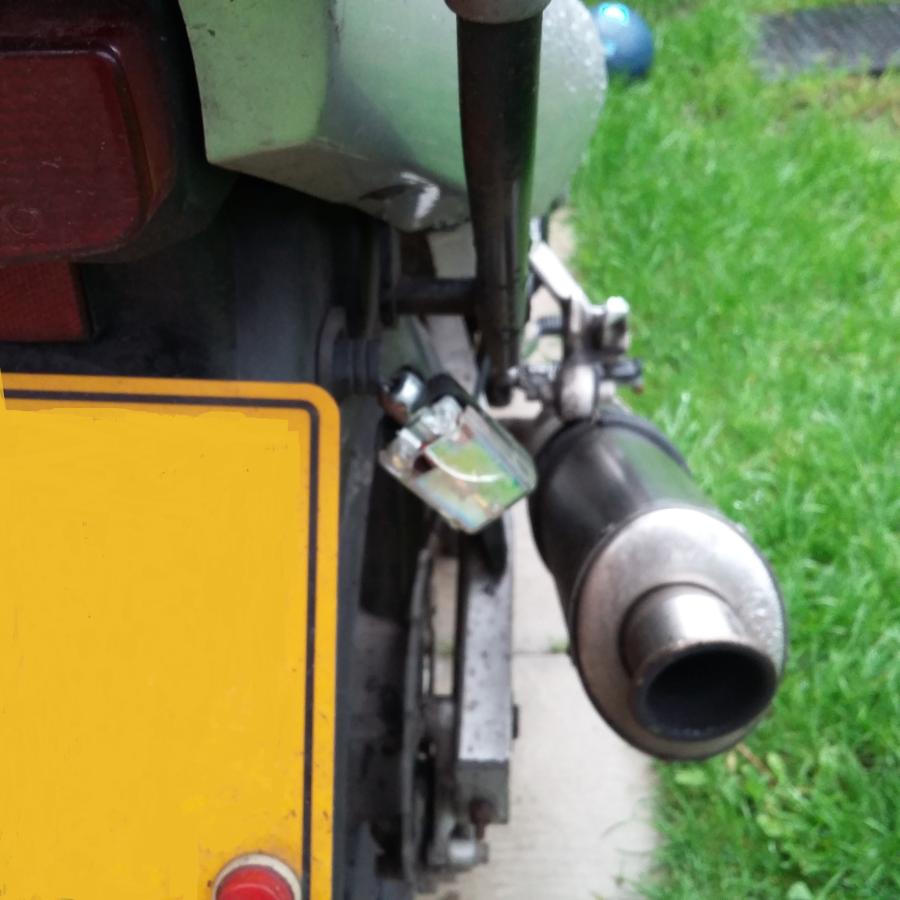

new indicators - celticdog - 13-06-19 Gents, does anyone have any reccomendations for aftermarket indicators? Have a look at the pic- I foolishly drove off with the chain still attached between the rear wheel and the givi arm :o If I go down the LED route rather than the bulb type, will I need to fit a new flasher relay? Any advice appreciated. Re: new indicators - Grayo - 13-06-19 LED is the way to go. Much brighter. Yes you will need to change the relay but the likes of M&P supply model specific LED relays and it is a 30 second job to change it. Re: new indicators - Disorderlypunk - 13-06-19 will need some of the little infills aswell to turn the egg shaped hole into a round one for the new indicator stem i just used some bloody big washers and painted them black, i trimmed my plate down a bit as well to give as much visibility for the cars behind at an angle Re: new indicators - darrsi - 14-06-19 (13-06-19, 09:11 PM)Grayo link Wrote: LED is the way to go. Much brighter. Yes you will need to change the relay but the likes of M&P supply model specific LED relays and it is a 30 second job to change it. I recently treated the bikes indicators to new lens covers and brighter bulbs, and they worked a treat. Although the old lens covers did clean up better than expected but were slightly tatty so have kept them as spares. https://www.ebay.co.uk/itm/10-x-UPGRADE-INDICATOR-BULBS-12-VOLT-27-WATT-BA15-BA15S-2-x-SETS-OF-4-2-SPARES/303040075094?ssPageName=STRK%3AMEBIDX%3AIT&_trksid=p2057872.m2749.l2649 Re: new indicators - midden - 16-06-19 (13-06-19, 09:11 PM)Grayo link Wrote: LED is the way to go. Much brighter. Yes you will need to change the relay but the likes of M&P supply model specific LED relays and it is a 30 second job to change it. Is that seriously the reason behind the led obsession..... Jeez Personally I'd say original all the way saves aggro of changing relays not to mention the question of reliability, will they fit securely along with possible cost (tbf there are some cheap options). If a road user doesn't spot the original indicator then they ain't looking |
