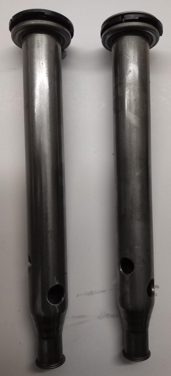

  Drilled my donor damper rods today. I opened out the original holes to 10mm and drilled another 2 holes of 9mm above, and at 90° to them, making sure not to go above 120mm from the top (Under the lip) Can anyone who has done the mod tell me if they think it'll be enough please?
Re: YSS PD valves - kebab19 - 09-04-19
Hello,Apologies, only just noticed this thread.It looks like you've drilled the rods out enough to overcome the original damping system. They should now be fine to fit in conjunction with the YSS valves.
