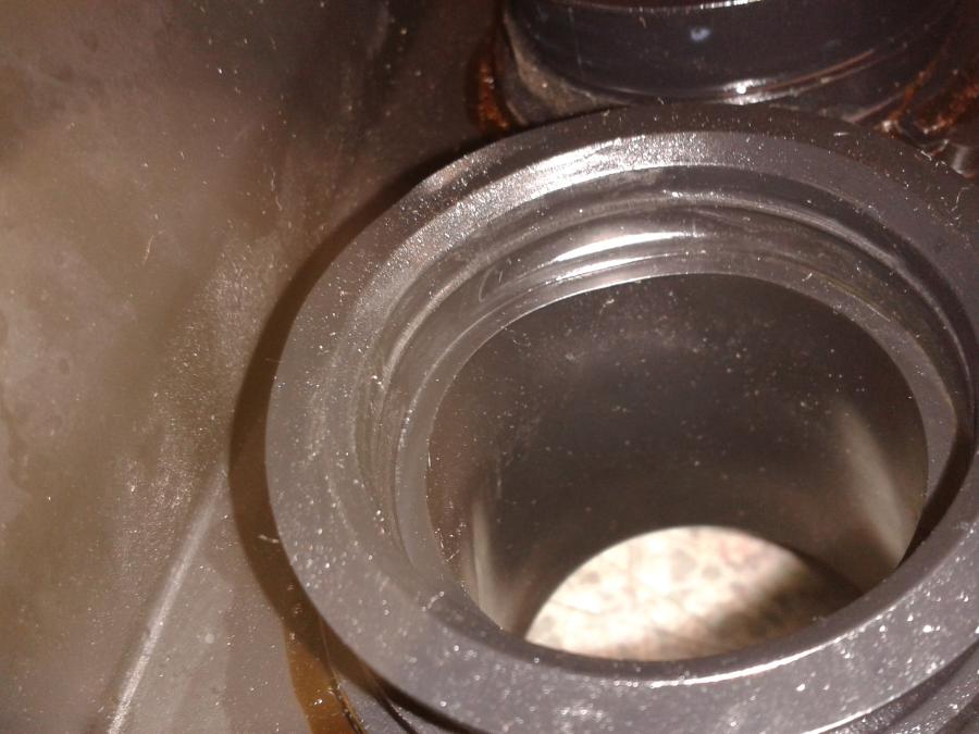

Airbox rubbers - agricola - 26-03-19 Noted the bike seemed to be uneven running when I was out on it last week, so decide to have a look if the injectors were out of balance. Noticed the one of the securing clips appeared to be slightly misaligned and the rubber, so pulled the airbox off to check. Looks like the rubber may not have been seating properly on the neck, and the clip has slipped off the neck alittle. There is a slight indent in the rubber and the rubber is slightly oval shaped (the indent nicely reflects light in the pic), so took the plunge and order 4 new rubbers and 4 new clips. All on backorder, but should be here within a couple of weeks |
