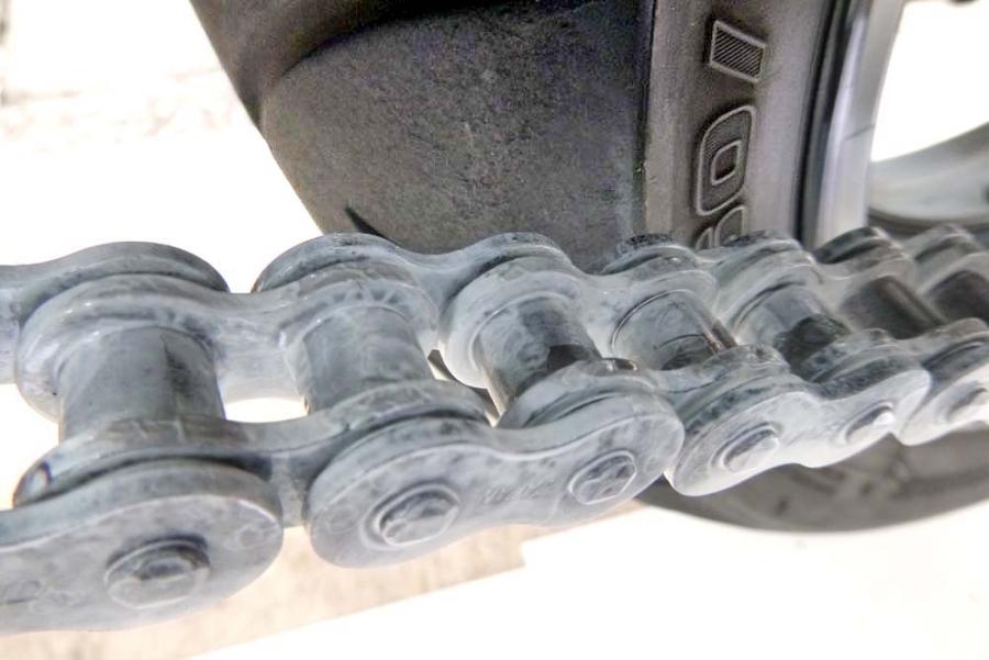

[/quote]I am nearing a new chain and sprocket set although its not badly worn the chain does have a tight spot that I can not free up and I can feel it when riding. I have always used chain wax but my riding is is all dry - so that's dust and grit that sticks to the wax. So I think when I fit new I am going to give engine oil a go and see how the fling goes. But cause I like my bike clean I may end up under lubing the chain.
Sorry for the post  :hijack  shieldr[Image: index.php?action=dlattach;topic=25083.0;...4879;image]
