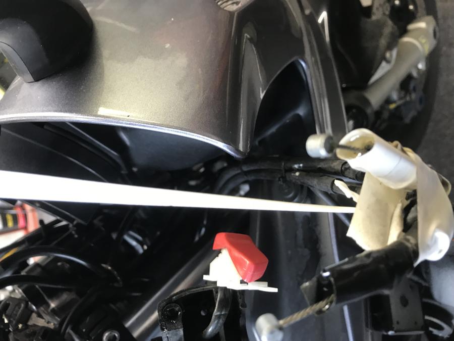

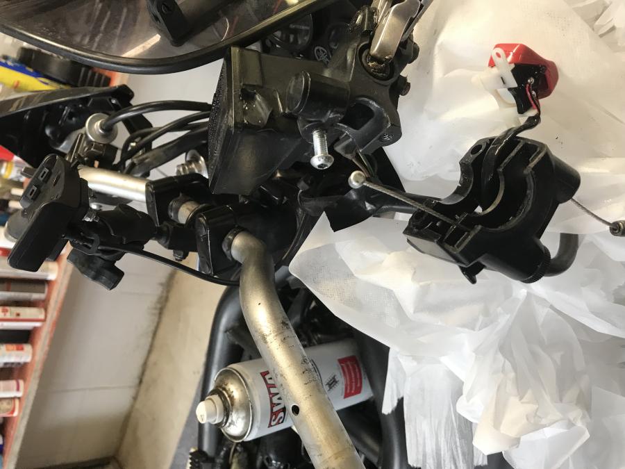

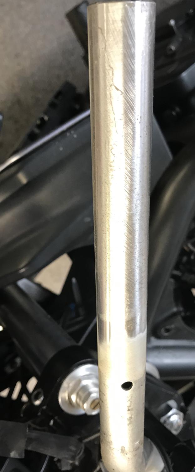

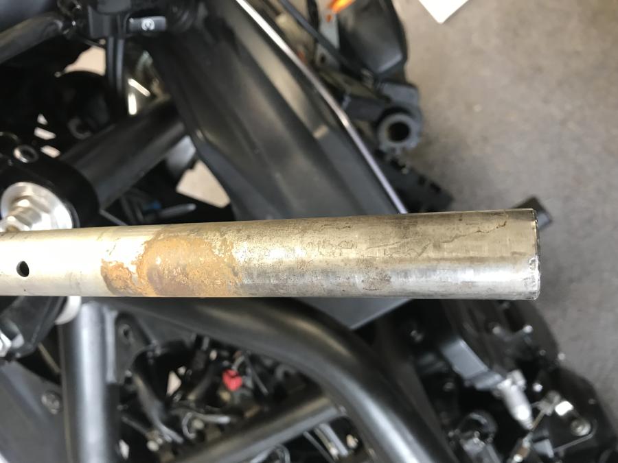

Sorted. Was my fault not the bikes. If you use your fazer all year round you gotta keep the preventative maintenance up.. I did not. Starter switch had corrosion so cleaned that out along with the run switch and it’s all tickety boo. Had noticed the throttle was stiff awhile back turned out cables were dry so ran three in one oil through them while it was apart, along with cleaning the corrosion off the bar end under the throttle and dry lubing it all. Smooth as silk now..
