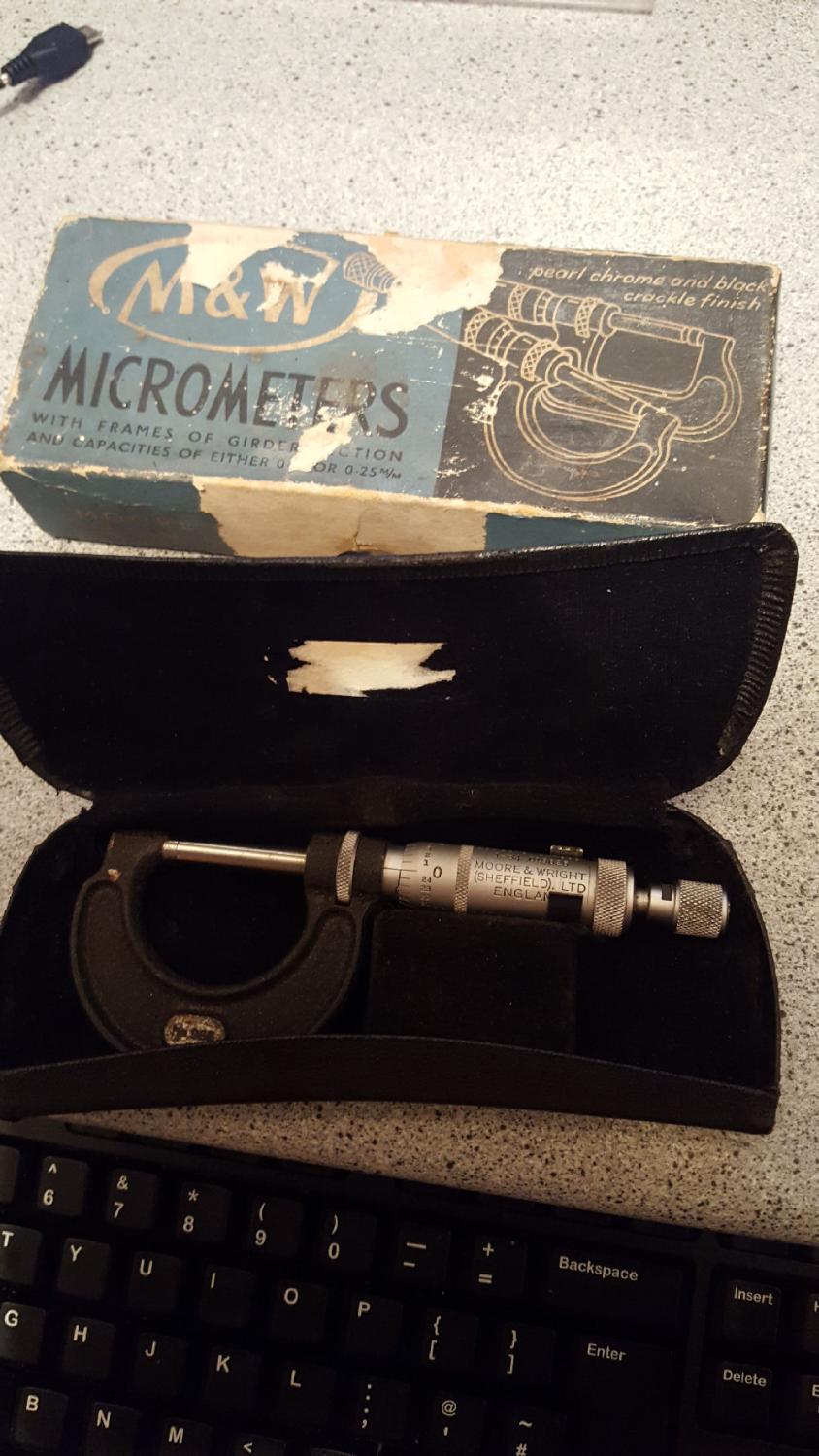

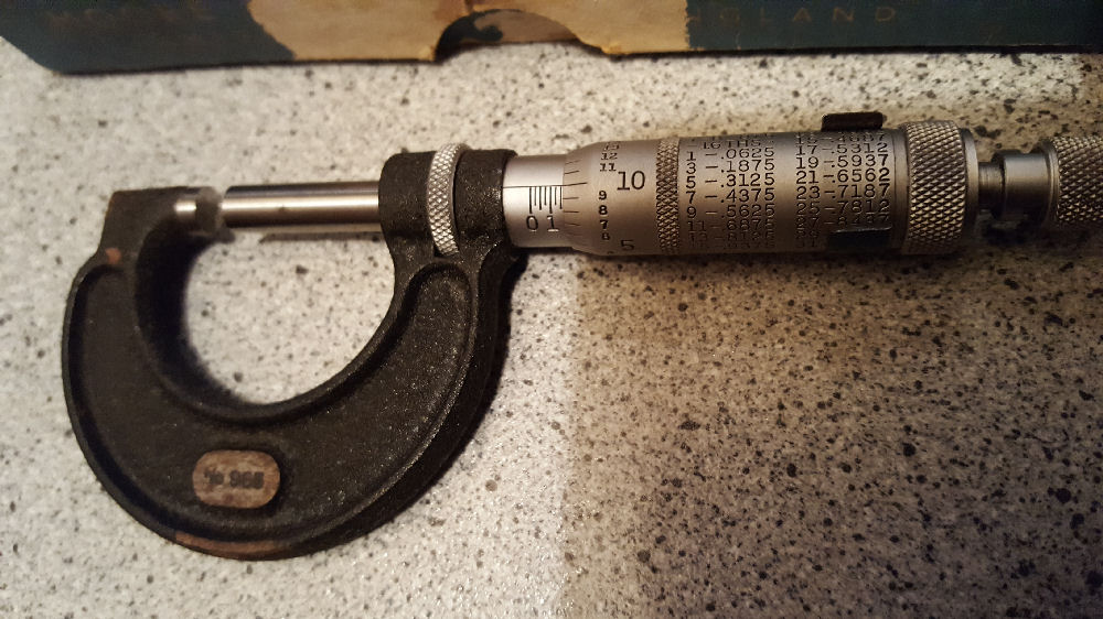

Re: Old measuring equipment - tommyardin - 19-03-19
Still got my imperial More & Wrights of Sheffield Mic, and my Vernier Gauges, agrees with earlier comment the vernier gauge is the most usfull one unless you working down to I thou of an inch, a piece of normal printer paper is 4.5 thou thick, just used mic on it.
Just noticed it needs an oily rag rubbing over it, probably the second time its been out of the box for about 20 years
