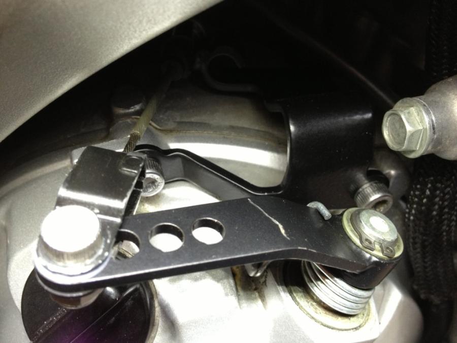

Also someone on Facebook suggested using the FZ07 clutch arm instead which is a bit longer, so gives you more time in the friction zone :thumbup

I've just ordered the MT07 (FZ07) clutch arm 1WS-16340-00 from Fowlers Parts although they've got to get in it from their Europe shop. I6 was £26 including shipping which was the cheapest I could find it, elsewhere it was £31.
When I get it, I'm going to install it and the new clutch cable which should sort things out :thumbup

I thought you meant the bar lever. You could have had this for nowt. I made it when I first started having trouble with my hand, later superseded by the hydraulic unit. It actually worked.
Re: How can I make the FZ6 clutch less snatchy? - Grahamm - 18-03-19
(18-03-19, 07:15 PM)agricola link Wrote: I thought you meant the bar lever. You could have had this for nowt. I made it when I first started having trouble with my hand, later superseded by the hydraulic unit. It actually worked.
The one I mention above is back ordered, I can take that one off your hands if it'll fit a FZ6-SA 2006 and cancel the one on back order. Drop me a PM.
