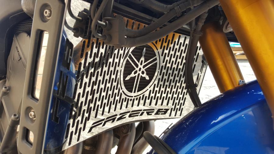

I make my own Radiator guards (stone guards) as well, using car radiator grille mesh, different shapes and colours available on e bay.  Smile
Re: Fender Extender - celticbiker - 24-02-19
I make my rad guards out of Stainless
