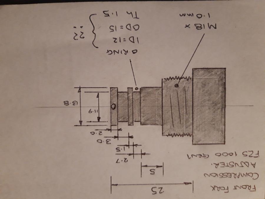

Re: Comp Damp Adjusters - again - ArchDruid - 10-03-19
It just so happens that I made a note of these dimensions when I was having similar issues.
I also looked at those same K-Tec ones as possible replacements …
I've attached the rough sketch of the original adjuster, if it may be of use to anyone.
The accuracy of the drawing and/or dimensions may be questionable but they should be close enough to give you a good idea  :-)
Re: Comp Damp Adjusters - again - ogri48 - 11-03-19
nice drawing mate, bloody helpful, though its a shame you live in Australia Wink
Re: Comp Damp Adjusters - again - ArchDruid - 11-03-19
Australia ??!  …. oh, I get it now ….  lol !  :-)
