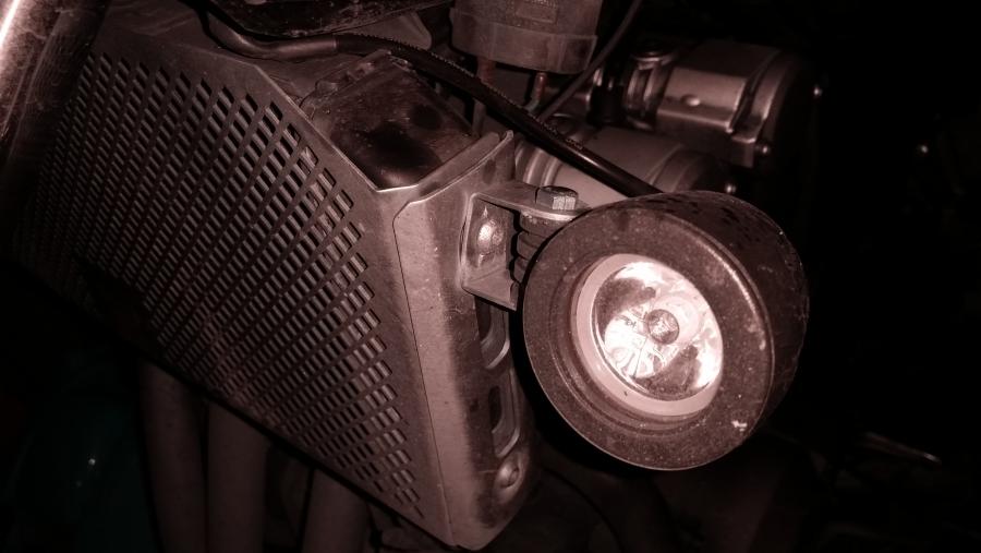

Re: Fitting Spotlights - Middy2000 - 06-02-19
I've mounted mine on the higher of the two bolts on the side of the radiator.  They're on but yet to be connected as I'm awaiting a switch which I've ordered as I've decided to have the option of turning them off.
I'm hoping to get everything done including the heated grips over the weekend.
Obligatory photo's will be posted.

Re: Fitting Spotlights - Middy2000 - 10-02-19
Well they're on & done.
Tried to run a feed via fuse box but couldn't get the connector out of the block to crimp a wire into so instead went into the connector box underneath the tank & found the ignition feed & cut into that.
Grounded everything via a bolt underneath the tank too.
Used the feed to put some heated grips on as well.
Can't for one minute think the ignition feed will be stressed by having grips & spots on them.
Anyway I believe it's obligatory to post pictures.
