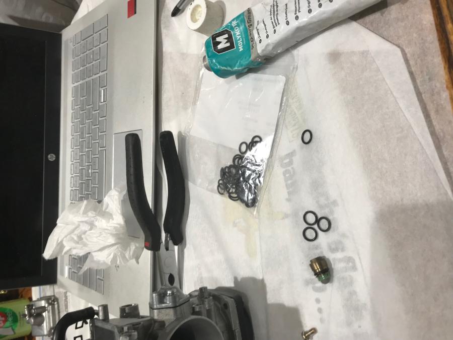

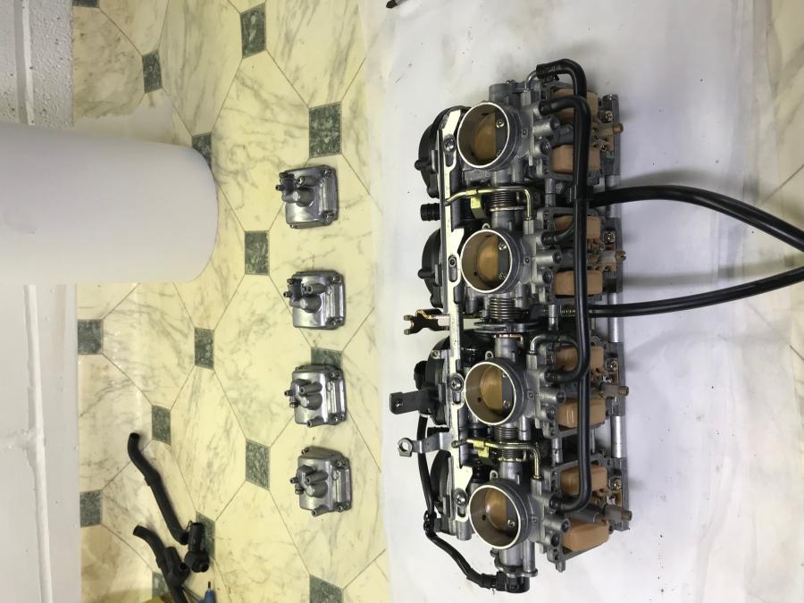

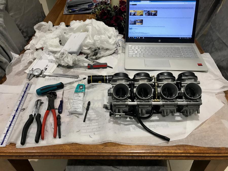

well whipped the carbs out of the thou today. when I say "whipped" errr..
aint the easiest set of carbs ive got out. Disconnecting that back throttle cable is an utter bitch lol. bt there out, cleaned up, and after tea I have permission from my little gruppenfuhrer to use the kitchen table and do the carb mods in the warm... Smile Smile JIS scewdrivers rock when getting off float bowls btw..

couldn't agree more. Gonna treat myself to some JIS long reach and stubbies too. Anyhoo job done. Very time consuming but if I ever have to do it again it should take half as long. mike was right about changing the o rings  in the intake filters, they were shot even though they hadnt been leaking. I used every bit of advice given...thank you guys. mikes tip about checking the float heights at 12.5 mm standard was double handy in particular. nice clean ivanised carbs going back in in the morning. hopefully ive done everything right (still not sure ive gone through enough with the bypass holes, very hard to guage a mil drop lol), proof will be in the pudding tomorrow  Wink Wink
Re: finally ivanising.. - ogri48 - 30-12-18
forgot to say, the spacers in my carbs were 3mm not 2.5, so the e clip had to be moved up a notch from the 3rd one down as fitted in the kit. pats site had it all covered so no problem.
