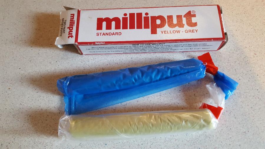

There is a resin putty material out there called Milliput that is brilliant
(I have used it on my Merc door locking system when a pipe snapped on the drivers door lock that works by compressed air).
Milliput did a brilliant job and you can mould it into a great shape so it forms a collar of reinforcement around the joint and can be over painted with a bit of silver or black and you would not see it.
Be sure to mix the two parts very very well together if you go down this route.
I keep a new tube in my shed all the time the stuff is brilliant.
When it sets it is as hard as china.

I also have some miliput in the shed but have the terracotta one that I used to hide/ fill some holes in some brick work.
I can recomend JB weld High Heat version, I used it to repair a hole in my collector box area on the Fazer and so far it has kept in place after other stuff fell off very quickly which was Chemical metal-- fell off and Gun Gum --- fell off.This stuff, same deal as miliput two part putty

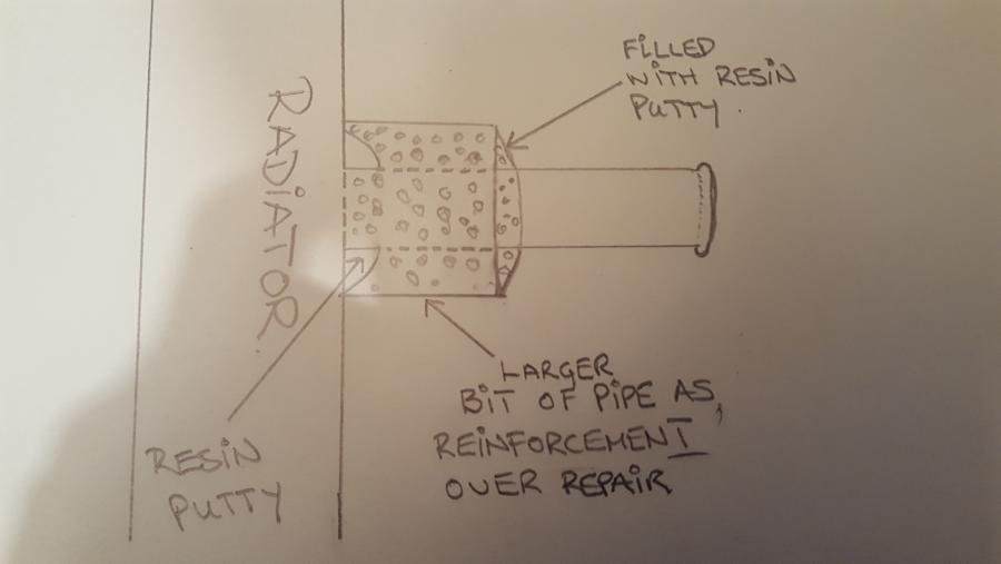

Which ever putty you decide on I am sure either will do the job just fine, ensure that you clean the area with a course emery paper to give a key and remove any dirt. Also make sure that the hose is attached to the pipe before fixing the alloy pipe to the radiator as twisting pushing and screwing the pipe back on could cause issues.
(Support the re[pair with string, bungees or block it in place while it sets)
I know with Milliput you can model the putty with moist fingers to give a smooth and tidy finish, It may be the same with others.
I have read somewhere that you can even drill and tap a thread into Milliput.

Don't know the situation or the rad pipe in question, but wonder if it lent itself to something like the pic below to reinforce the joint after it was made.

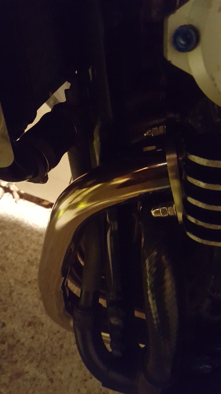

Re: FZS600 Radiator woes- wee pipe came off!! Get it welded back on? - robbo - 10-12-18
Maybe not such a good idea to have stainless studs and nuts. This has been discussed before, and a better option would be steel studs and stainless nuts, with the possible option of stainless cap nuts to seal the end of the stud. It's been known for a stainless/stainless combination to gall, or fuse together. The steel stud/ stainless nut/cap nut, was the route I chose to go on my thou, and has worked out fine.
Re: FZS600 Radiator woes- wee pipe came off!! Get it welded back on? - tommyardin - 10-12-18
(10-12-18, 06:36 PM)robbo link Wrote: Maybe not such a good idea to have stainless studs and nuts. This has been discussed before, and a better option would be steel studs and stainless nuts, with the possible option of stainless cap nuts to seal the end of the stud. It's been known for a stainless/stainless combination to gall, or fuse together. The steel stud/ stainless nut/cap nut, was the route I chose to go on my thou, and has worked out fine.
I am with Robbo on the S/S nuts on S/S studs, Galling or Cold Weld can happen and if it does you will never move then again, as robbo said either plain studs with S/S nuts or S/S studs with plain steel nuts. Light smear of copper slip on the thread before doing them up. Again what I did was to spin 8 domed nuts over the top of the stud nuts, they act as locking nuts and help keep the moisture out.
