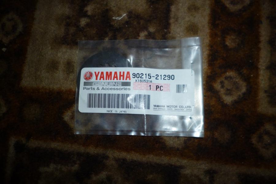

Re: Front Sprocket Nut - Anquetil - 29-10-18
Here is the 12mm nut. I replaced the 9mm version on both of my Fazers.

Re: Front Sprocket Nut - darrsi - 29-10-18
Not seen that part number before?
Re: Front Sprocket Nut - darrsi - 30-10-18
(29-10-18, 11:59 PM)darrsi link Wrote: Not seen that part number before?
My bad, i recognized the first numbers, but not the second part, but after a search there's no other number.  Smile
Might be the nut/washer kit part number i remember?

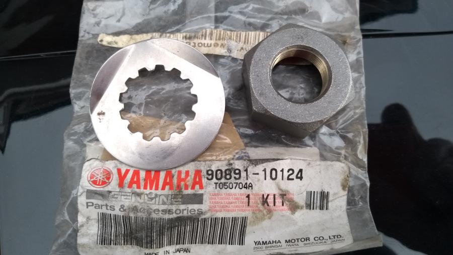

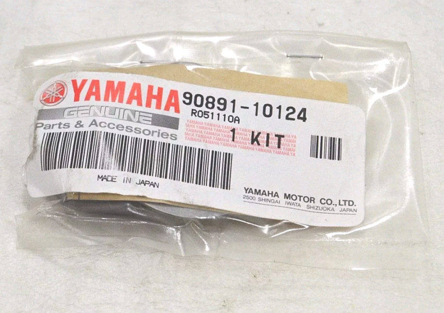

Re: Front Sprocket Nut - Anquetil - 30-10-18
Here is the washer.
This is the one i was thinking of, but it would seem that they now sell the nut and washer separately rather than as a kit now.

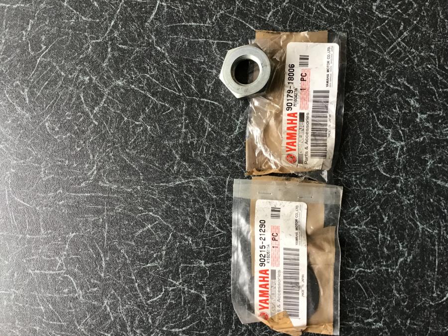

Re: Front Sprocket Nut - FILZ6 - 30-10-18
Hi all. These are the nut and washer I was supplied with when I purchased my fox eye.
