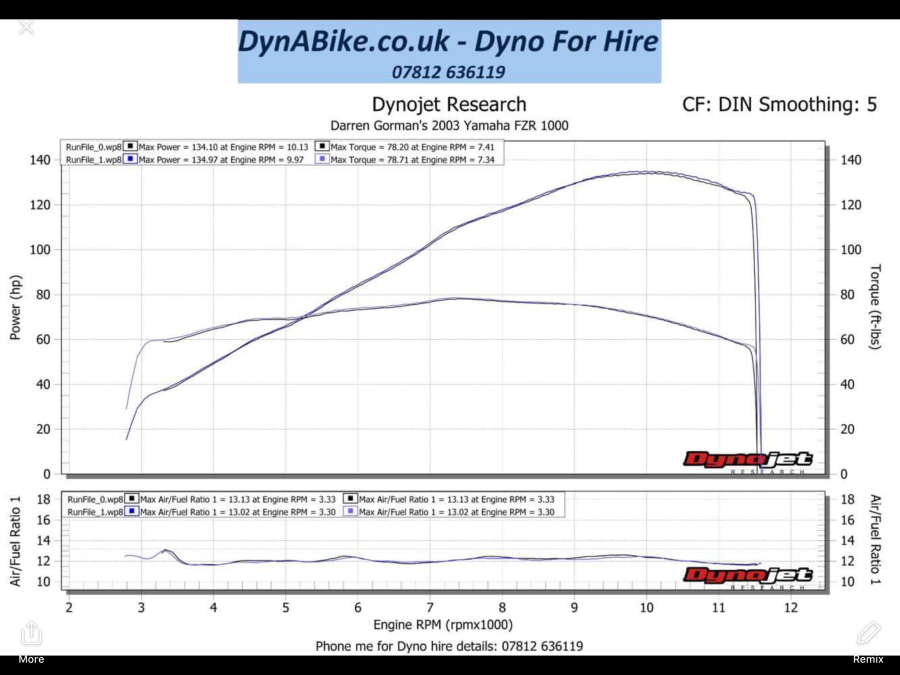

Standard I would say mid 120's to the rear wheel.
A little bit of Ivans magic and you'll be pushing mid  to high 130's.
So, I would say that the claimed power output was pretty spot on.
Of course, you have to take into consideration the difference between crank and rear wheel figures.
Re: 143bhp - PieEater - 26-10-18
I don't know if they still do it but manufacturers always used to quote max BHP figures taken from the crank rather than the rear wheel which is most likely where the 143 BHP figure comes from. The rule of thumb is that you get about 15% power loss from the drivetrain between the crank and the rear wheel so from 143 at the crank you would expect around 121.5 at the wheel. Hence if you check Ivan's Dyno Charts you'll see that his benchmark bike at stock made 121.7.
As dazza says with an Ivan's kit you can expect mid 130's or higher if you invest in (if you can find one) a top quality replacement exhaust system.

Presumably more will be available?  If not buy it.  Buy it now!  I have the slip on can jet kit which was fitted by Mike.  Basically it gives you a nice big lump of low down grunt that isn’t there on the standard bike, and it gets rid of the horrible surging that plagues the thou at low speed with a small throttle opening (think 30mph in 6[sup]th[/sup] through towns).  Oh plus 10bhpish up top.  But forget the extra grunt and power (which is nice) it's that it smooths everything out that is the nicest bit.
Quote:I have seen it mentioned on here that the 143 bhp that Yamaha states for a standard Gen 1 power output is bollocks!
I think it’s probably stop on, and as others have stated dyno runs have also suggested it is about right.
The four best mods from standard you can do (in my humble opinion), are Ivans jet kit, straight through can (the right length please), AIS removal and aftermarket rear shock.
