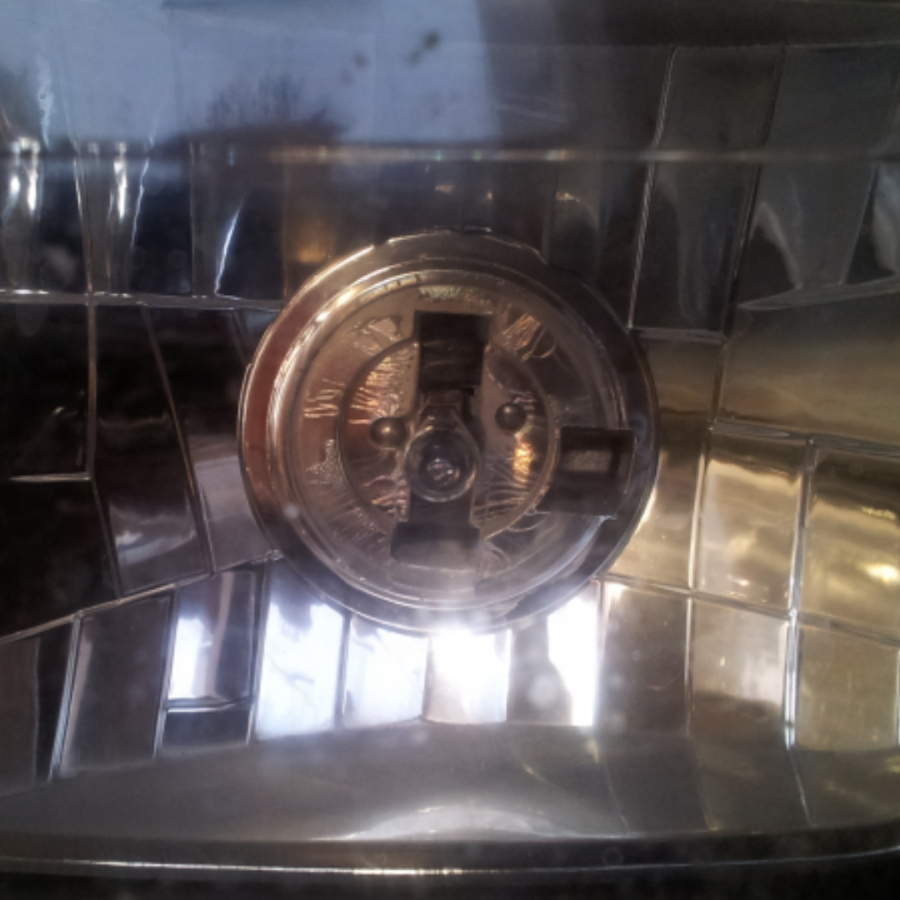

I know it's quite a hard material around the bulb that contains the holder, even though it does eventually erode away through vibration, but do you not think it would be possible to open up the hole with a Dremel to make it hold another H4 bulb?
Has anyone ever attempted this before with success?

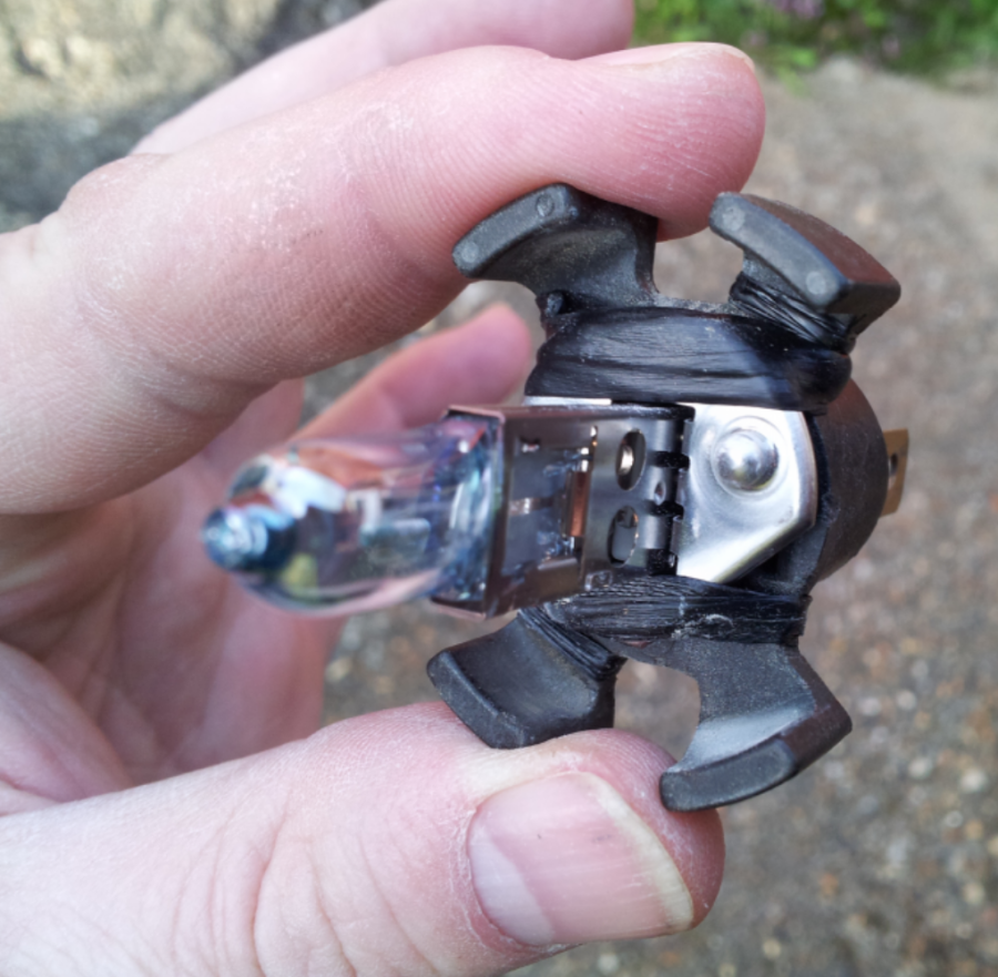

this is due the fact the H1 bulb holder has 2 locating lugs that fit into the lugs on the back of the headlight, so if i cut it away (at the headlight end) the bulb holder will have nothing to 'locate' into and it will not be tight, i dare say the spring clip will hold it in place but cannot take the risk of it rattling around in the headlight.

Just so people know what we're on about.
Re: Different Headlamp - darrsi - 27-10-18
The amalgamating tape i put on there was to stop buzzing/vibrating of the bulb against the housing, which if left would gradually chip away at the housing over time, plus drive you made with the noise as well.
