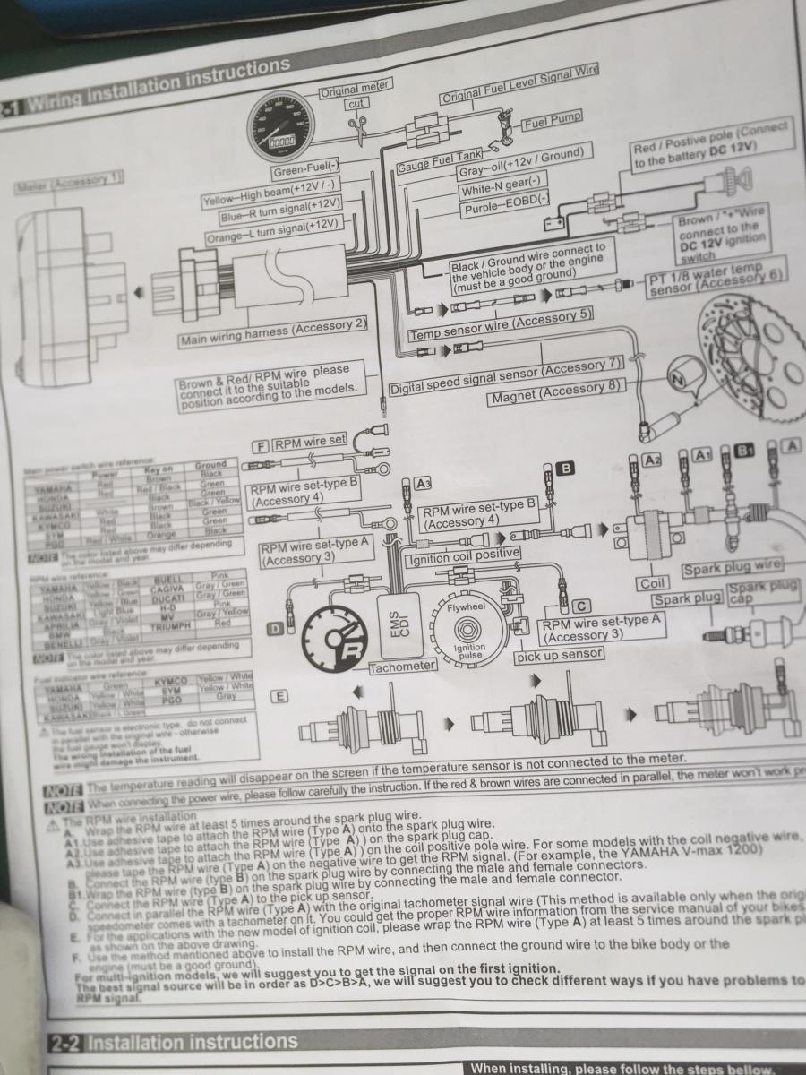

Oops.....tricky wiring! - Andy W - 02-08-18 Well I certainly don't make life easy for myself! :rolleyes Have bought a Koso DB-03R multi-gauge......now it's out of the box I'm looking at the wiring instructions & thinking I've bitten off a very large chunk of headache pie! Aaaargh! :'( Re: Oops.....tricky wiring! - celticbiker - 03-08-18 Let's have a look then. If it doesn't look like this then you'll be fine. Re: Oops.....tricky wiring! - Andy W - 03-08-18 Quite right, it's not as bad as your pics! I have had a good look again this morning & the Koso wiring is simpler than it looked yesterday evening (I am sober now which may have something to do with it! :rolleyes ) Much of it is showing various ways to fit the RPM wire depending on your bike so can be ignored. Also, I splashed out on the GPS speedo adaptor so that's an easy plug in fit! Mind you, there are also endless pages of set-up instructions! :eek It's the cheapest decent brand multi-gauge I could find but it's a small unit tho' so will look a bit daft replacing all the dials but I may fit the Garmin next to it to fill out the dash a bit! Re: Oops.....tricky wiring! - Hugh Mungus - 03-08-18 (02-08-18, 07:24 PM)Andy W link Wrote: I'm looking at the wiring instructions & thinking I've bitten off a very large chunk of headache pie! One wire at a time. Don't try to rush the job. Draw a diagram of the wires on your bike noting the colours and what they do, then just match up the new wires. If you draw a diagram/table it will be easier to follow when connecting the wires up. It will also be very useful to keep for the future. Re: Oops.....tricky wiring! - Andy W - 03-08-18 Ok Gurus, I need some help please if any of you have fitted this type of thing before.... Q1/ The Koso white wire is for gear indicator, once fitted, there is a procedure you do which means the unit apparently learns your gears. The diagram seems to imply that you just take the white wire to neg.....can that be right? Q2/ The Koso comes with it's own screw in temp. sensor, could I not just tap into the existing sensor wire? If not, where on earth is the Fazer's temp. sensor to be found? Q3/ What on earth is an EOBD? :eek Currently regretting very much buying this unit so any advice greatly appreciated! :o :\ Re: Oops.....tricky wiring! - tommyardin - 04-08-18 EOBD : European On-Board Diagnostic : It is a diagnostic or electrical fault finding scanner. Re: Oops.....tricky wiring! - Andy W - 04-08-18 (04-08-18, 07:40 AM)tommyardin link Wrote: EOBD : European On-Board Diagnostic : It is a diagnostic or electrical fault finding scanner. Thanks - does the Gen.1 have such a thing? Re: Oops.....tricky wiring! - Andy W - 04-08-18 Well, hopefully I'm getting there slowly....according to the supplier the EOBD wire can simply be ignored if the bike doesn't have one fitted, & the white wire just connects to the neutral dash light wire. Fingers crossed.......... ![]() |
